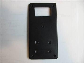

I planned to put the circuitry into a plastic case 15cm X 7cm X 5cm. I always make a template out of cardboard or other soft material so that I can have the best chance of properly positioning my peripherals before I start drilling and filing. My tools include a drehmel, files, hand drills, and other simple tools. This is the hardest part for me as I am a bit of a specialist in having drills walk away from my intended drilling site and I also specialize in slipping and scratching what should not be scratched. This time I was fairly lucky and was able to cover up my mistakes with a little file work.
I now began to mount the jacks, meter, potentiometer, fuse holder, and drilled the circuit mounting hole in the back and input wire access hole. If you ever work with one of these Chinese meters it is important to remove the circuit from the bevel before inserting it through the hole as the retention clips will not retract with the circuit installed. I also filed the bevel of the meter so that it was a little bigger as it obscures the lower segments of the display from the supplier. Here is a picture of the internals after the wiring was complete.
