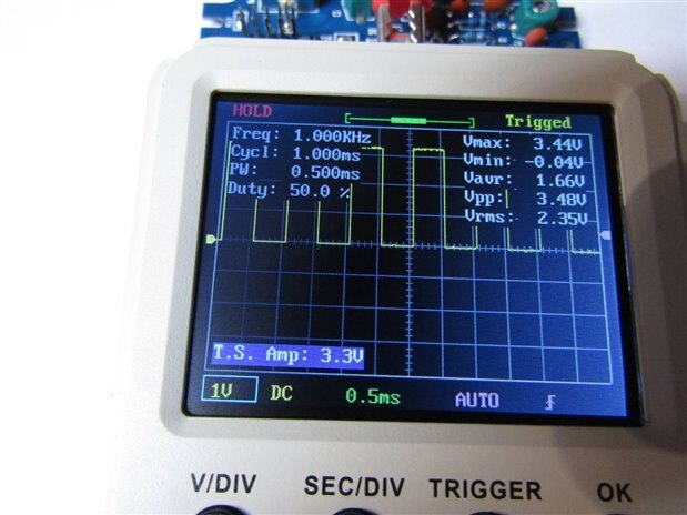

One feature that I was really pleased with is the ability to toggle on and off a list of measurements. Usually on a meter this size and cost one is left to guess what the digital data is. Here is what the unit looks like with the measurements displayed:
