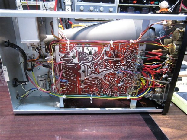

The first step was to break it open and clean some of the dust off the circuit boards.
This is state of the art for a low price scope in 1974. It is all transistors except for the CRT. The cabling to the boards is wire wrapped to pins. This is the underside of the Horizontal Control Board. I began my repair process by spraying and cleaning all the pots.

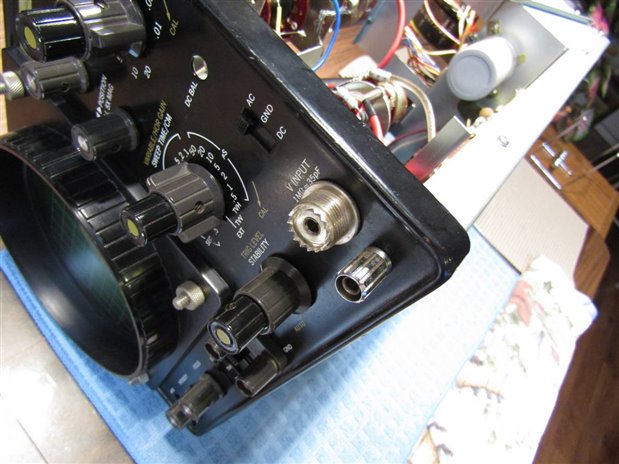

The final thing I wanted to do was to get rid of the old clumsy original probe with its PL259 connector. My first thought was to remove the SO259 on the panel of the scope and use washers to position the much smaller female BNC jack.
However after studying the situation I decided instead to build a PL259 to BNC female adapter and leave the original SO259 in place. I did not feel that I could do a professional looking job. While the adapter would stick out, the position of the scope on my bench would not make this a problem. Here is the finished scope with its new adapter and probe.
