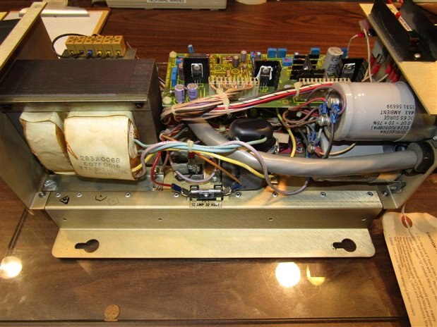

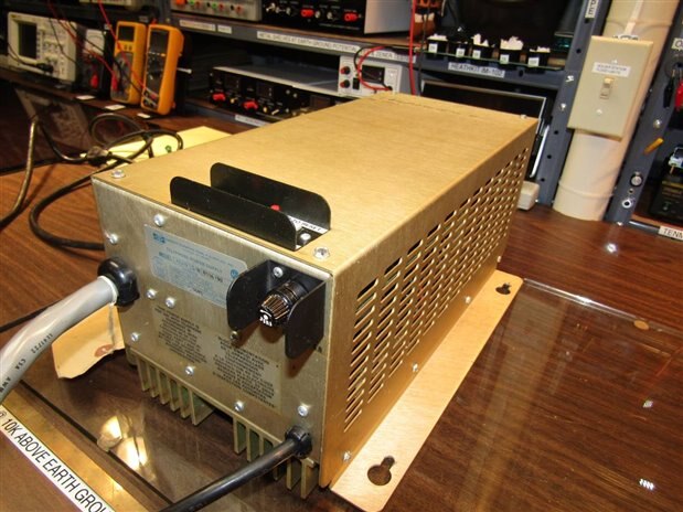

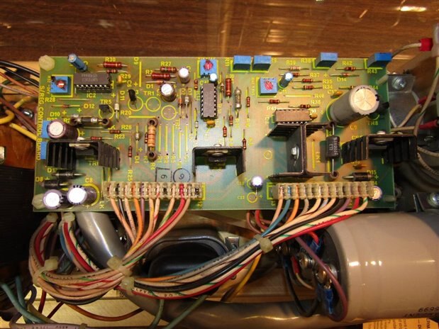

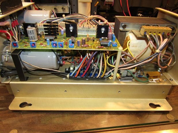

Today I pulled an old telephone system out of a store that was no longer using it. The one thing that caught my eye was this Harmer Simmons RD 219 Power Supply. It is a beast of a linear power supply with +/- 24 Volts at 4 amps and 5 Volts at 7 Amps.
Weighing in at 11 kilograms it would probably make a pretty good boat anchor. Here are some internal pictures.
Based on the date codes on the chips this is mid 1980s technology and it was probably considered pretty good quality. Taking the nominal ratings we have a potential 500 Watts of line power with an output of about 250 Watts. The unit still works but it has a moderate 60 Hz hum from the transformer. This unit is probably totally obsoleted by today's Switch Mode Power Supply technology. Some of the first SMPS were making their debut in the early 1980s but they were not very wide spread by the mid 1980s from what I can gather. There may have been other considerations for using a large linear supply to power telephone systems as well.
If anyone has any ideas for a good use for it let me know. In the meantime it will join the collection of things rated too cool to salvage.

    Hi John! It looks really nice : ) It could be sold as an audio supply for those who want no switch mode noise maybe. The +-24V outputs could be handy for that! I was wondering, did you clean it, or was…

    What a monster

    Hi Shabaz, All I had to do was blow off a little dust otherwise this is how I found it. I got a bunch of Business Com circuit boards too and I have been studying and crossing the chips. My boards are usually…

    Given the date of the supply, the PABX phone system of it's time would have been rather large as well, so the weight isn't an issue.
    While SMPS were around, I would think that for long term 24/7 operation you're starting to get into a few years before the passives start aging.
    I would also imagine that many of the companies building these beasts were set in there ways, but now the trend is to assemble from sourced parts so they go with what is more cost effective.
    I like linear supplies ... they don't go bang. image
