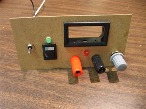

Our initial steps were selecting the proper Transformer and laying out the other components, in the room left over after the transformer took up half the enclosure. We also began to plan our control panel by making a cardboard template. Here you can see some of the controls as they will be positioned on the unit.
Once we had the template we marked and cut the aluminum of the enclosure. We also marked and cut a piece of white plastic which would serve as a front cover for the original markings on the Cure Light. Ivan used a coping saw to cut the Aluminum for the rectangle meter hole and we used the drill press for the round holes. We left the power switch in its original spot. After lots of cutting, filing, and adjusting here is the finished control panel.

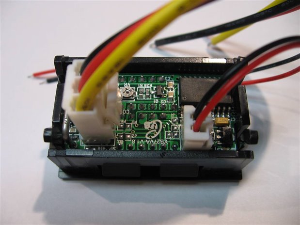

    Jan Cumps over 10 years ago
    How does the AMP part of the meter work? I don't see anything in the meter it in series with the load?
    edit: ah, it seems to be in the ground path.
    jw0752 over 10 years ago in reply to Jan Cumps
    Hi Jan,
    Here is the information on the meter. First of all a link to the e-bay listing:
    http://www.ebay.com/itm/DC-0-100V-Digital-Voltmeter-Ammeter-Dual-LED-Panel-Amp-Volt-Power-Meter-Guage-/181128828750?hash=item2a2c1e974e:g:P-EAAOSwl9BWJeNq
    As you can see the dual meter is very reasonable at $2.90 each. Shipping to the US has been greatly improved by China. I can get things like this in usually less than 10 days.
    Here are a couple closeups of the back of the meter so I can answer your question about the Amp reading;
    The metal bar on the right side of the top picture is the shunt for the ammeter. With this internal shunt the meter will read up to 10 Amps. There is also an external shunt available that will extend the range to 100 amps. Note there are two small resistor trimmers for adjusting the volt and current readings. The current is sensed through the Ground Connection. For example, you can see in the schematic for Ivan's power supply the Large Black wire enters the meter and then the Large Yellow exits the meter and supplies the output ground connection. The Large Red Wire is the Voltage Sense wire for the meter. The small red and black wires are the power source connections for the meter. This has to be 3V to 30 VDC. It can be the same voltage that is being sensed as long as it doesn't exceed the 30 VDC max. If the power supply is in the 3-30 VDC range then the meter's Red Voltage sense wire can read as high as 100V. This meter will not read negative voltages. The only other thing I have learned about this unit is that it is necessary to remove the circuit board from the housing before snapping the housing into a panel cut out. Then one can put the circuit board and LEDs back into the housing.
    Thanks for your question
