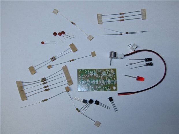

Thanks to Christmas Vacation I had the opportunity to spend the day doing electronics with my 11 year old Grandson Ivan. We began with a small Chinese noise actuated clap switch.
https://www.ebay.com/itm/VOS-Voice-Operated-Switch-DIY-Kit-Voice-Switch-Electronic-Production-Suite/222649153280?hash=item33d6ec7700:g:1cAAAOSwnDZT5G~0
As you can see the kit comes with no directions other than the silk screening on the board. I had explored this kit a while back and reverse engineered a schematic so Ivan had that as a guide as well.
It is a simple 2 stage audio amplifier that triggers a transistor flip flop which in turn lights a small LED. It is designed to operate at 5 volts. Ivan has become very adept at building these Chinese kits and he is also knowledgeable about my shop. With few exceptions I just turn him loose and let him work. Today at one point he got too much solder on the board so that two pads were bridged. I did not realize this until I saw that he had retrieved the solder wick from the drawer and was making the proper remedy to the problem. As he worked we discussed how we could take this simple, not so practical, circuit and make something useful out of it. The idea came up that he would like a light by his bed so that when he got up at night he could just clap and have light.  I began to check for resources in the shop and found a small 2 watt 12 volt LED panel, a 12 volt linear wall wart, a project box of the right size, a nice prototyping board, and a power switch. Since we would be building the kit to integrate with the rest of the components I told Ivan to leave the microphone and power jack off the board. We would mount them to the project box when we assembled the whole unit.
