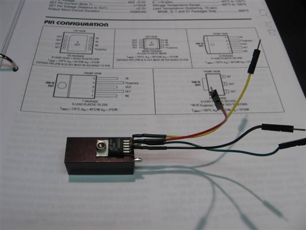

Since I am fairly old fashion I was pleased that the device was still packaged in a through hole TO 220 design. I may or may never actually build with the component but for experimental purposes it is much easier to prepare the part if there are leads to solder to. After printing and reading the Data Sheet my next step was to prepare the component so that it can easily be bread boarded. I will do this by soldering bread board jumpers on the pins and then mounting the LT3080 to a small Heat Sink. Here is a picture of the prepared device.

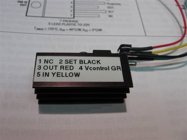

It will come as no surprise that I have labeled the leads so I do not have to keep going back to the data sheet to verify correct hookups. While this small heat sink would be inadequate for any long term high power application it is big enough for short tests and experiments. Later in the experiment you will see what I do if I feel that I need more heat sink than provided.

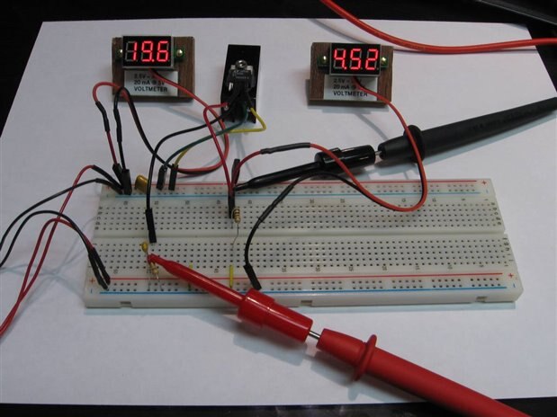

The next part of my exploration involves hooking the device up on a bread board and testing it to see if it really does what they say it will do. Here is a picture of my experimental setup:
Unfortunately even with good planning and a very simple experiment things can and do go wrong. Here are the difficulties that I encountered in the first three hours of experimentation.
The LT3080 did not work as advertised. It was difficult to get it to begin regulating and when it was working the slightest capacitive extra load would cause it to drop out. I could not get it to start with my electronic load attached. To add the electronic load I would first have to put the load in series with a 330 ohm resistor and then short past the resistor.
I also was experiencing a situation where the external set resistance needed to be 2 magnitudes smaller that called for by the data sheet specs in order to control the output. Measured current from the internal current source was only 10 uA at very low input voltages and it was not stable, rising with an increase in input voltage. When the regulator was actually working the current from the Set pin was very close to 1 mA.
I experimented with different voltages, resistors, decoupling capacitors, and various resistive and capacitive loads. When one is new to a component it is easy to feel that you have done something wrong so I tore the bread board down and redid it a couple times. I also searched to see if there was a different data set that applied to the TO 220 version which I had purchased compared to the smd devices.
I have learned from experience that when handled properly the problem is very seldom the IC itself, but having exhausted all the other possibilities at 2:30 AM I decided to prepare the second chip that I had purchased and to see if that one worked better or if it gave me the same problems as the first.

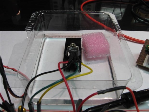

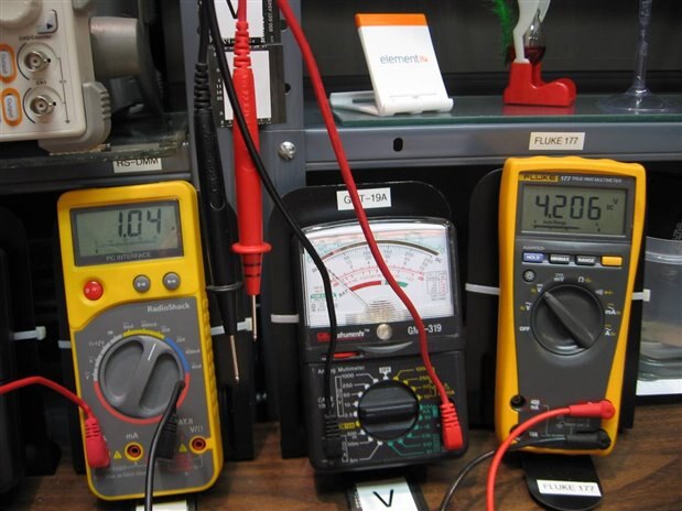

Thankfully the second LT3080 worked as advertised. This allowed me to put the experiment aside and crawl off for some sleep. This morning, all refreshed, I went back to work running my simple tests to see the limits of the regulator. During these tests the electronic load worked as intended and I was able to raise the current to the limits of the device which allowed me to see how the internal current limit would work. If you look carefully at the next picture you will see what I do when I need more heat sink as I did in these stress tests.

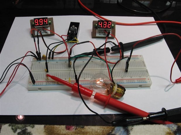

I put the Styrofoam in the water so you can see the level. In this case just enough to cover the fins of the heat sink. In the next picture you will see how I am also using a light bulb for an extra test load and the little bread board meters are monitoring the input and output voltages. The two digital bench meters are monitoring the output current and the Set pin voltage respectively.

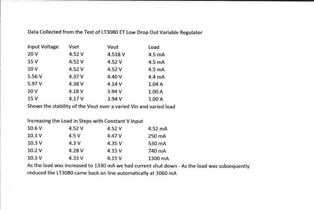

Here is the data from my tests. I was able to satisfy myself of the very good stability of the output regardless of how the input voltage or load is varied. On the output current limit I found that around 1330 mA the internal current limit would engage. This would drop the voltage output to a very low level and the current would drop to about 1000 mA as the electronic load attempted to maintain the load level. When I manually reduced the electronic load back from the 1300 mA level the LT3080 came back on line as soon as the load approached 1000 mA. Here is a simple data sheet of my measurements:

    The first additional experiment that I wanted to do is see how well paralleling the LT3080 works. One of the limitations that must always be faced in experiments is the limitations of the test instruments of the lab. In my case I have good confidence to the level of 10 mV, 100 uA and 10 mOhm. While this is not very good for any precision decisions it is more than adequate for the level of experimentation that I am currently doing. For this experiment I mounted a second LT 3080 as I did before but I did not have an identical heat sink so the two devices are potentially not running at the same temp. I changed my extended cooling ability by putting a small 12 V fan directly on the two devices. The ballast resistors that I used for this experiment were 100 milliohm as opposed to the 10 milliohm called for in the application sheet. This was a result of the available resources and ability to easily construct the recommended values. I also wanted to read voltages across the ballast resistors to determine the individual LT 3080 currents. The two devices performed well with a combined current load of 2.15A with one device taking 56% (1.21A) of the load and the other handling 44% (0.94A). I am certain this would level out better if I was able to lower the ballast values and equally heat sink the two devices.
    For this experiment I was not able to use the electronic load as it is only available as a constant current load. Therefore I am back to using the old trusty automotive tail light. Under a this load I was able to set the current from 0 to 0.41 A using the recommended set up. The application indicated a 0 to 1.0 Amp capability but I was not able to get more than 7 volts to drive the bulb with an input of 13 volts which limited my current to the measured 0.41 A. I would then vary the load slightly by adding resistors across the light bulb and observing the change in the current output. The stability of the current was acceptable for the crudeness of the breadboard set up with all its inherent variables. Available time and interest limited my pursuit of further unanswered questions at this time.
