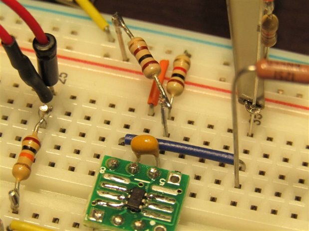

My first challenge after receiving the chip from the vendor was putting it onto a workable board. I should be starting to get used to the size of these new surface mount ICs but they always seem to surprise me. The device that I received is a TSOT-23 package and way to small to deal with unless it is mounted on a board. I had some converter boards on the shelf but none of them were perfectly suited to this device. I finally ended up using an SOIC8 adapter board and although the legs didn't match the spacing on the board exactly I was able to solder bridge the difference. Here is the finished device now the size of a regular 8 pin DIP.

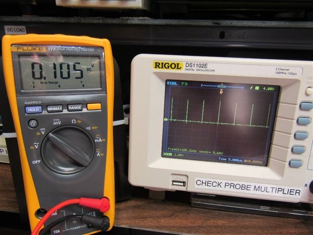

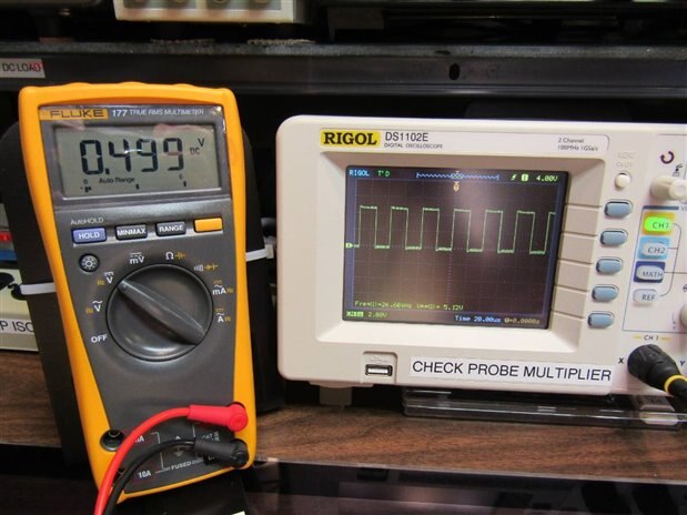

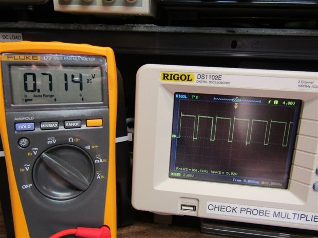

Here are pictures of the Mod voltage and the Oscilloscope output for voltages of 0.5 volts, 0.714 volts, and 0.105 volts. I am using a 470K resistor on the #3 Set pin which produces a frequency of 106.4 KHz on the output. The Data Sheet provides a simple formula for calculating the frequency. I found that the actual frequency very closely match the calculated frequency. For this part of the experiment I had the Divide Pin 4 tied to ground so that my divide by factor was 1. This also put the Mod to Output in a positive correspondence. PWM increases 0% to 95% as Pin 1 voltage increases 0.1 volt to 0.9 volt.

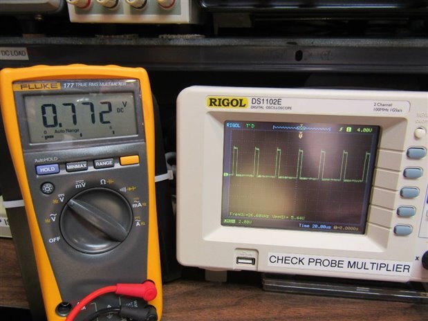

My next step was to switch the configuration of the resistors on Pin 4 so that the correspondence of the change of the input to the output would become negative. In this case as the Voltage on Pin 1 changes from 0.1 volt to 0.9 volt the output would change from 95% PWM to 0% PWM.
Here is a close up of the bread board at this point and a shot of the Oscilloscope showing the negative correspondence with the 0.772 volts corresponding to a very low % PWM.

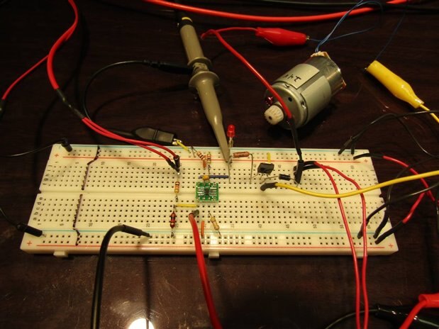

The last part of my experiment was to add a 24 volt motor and a N CH MOSFET to drive it. Here is the breadboard set up.
