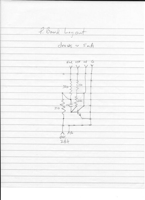

I made a preliminary plan on one paper and then a board layout on another. I was able to compress the circuit into a 5 X 9 matrix. Here are the planning papers:

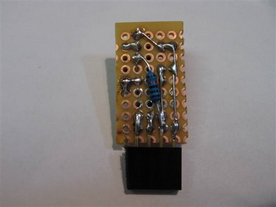

I wanted to use 1/4 watt resistors as that is what I had and they required more space. By using both sides of the board I was able to construct this small pre-amplifier circuit:
The black female header will mate with the angle header pins on the main board and also support the circuit board. There will be a insulated barrier between the two boards so that they can not short to each other. The small green header is the connection point for the BNC jack on the front of the unit. Here is a picture of the pre-amp mounted to the main board:

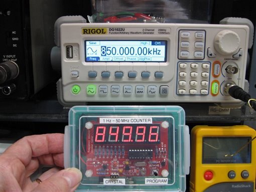

The unit worked pretty much as would be expected for a $7.50 kit that had been modified by an old tinker. The pre-amp must have introduced a little noise to the PIC input which the PIC tries to decode so the unit does not stay at zero when no input is present but reads around 150 Hz. The input voltage sensitivity is satisfactory and goes down to 500 mV on moderate to low frequencies and as low as 200 mV at the higher frequencies. The unit will read only down to about 500 Hz as compared to 1 HZ when the input was connected directly to the RA4 input of the PIC. This is undoubtedly caused by the increasing impedance of the 47 nF capacitor in the pre-amp input at these low frequencies. As I continue to play with this unit I hope to make some minor improvements. The crystal oscillator seems to work very well with some crystals and not so well with others. I will also be investigating this problem. The oscillator problem always existed but it seems to have gotten worse with the pre-amp modification so this warrants additional investigation.
