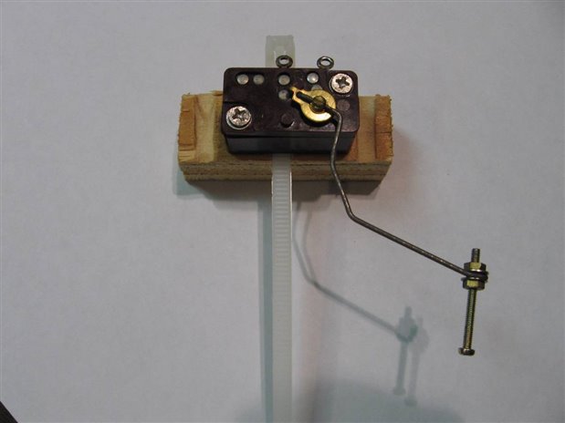

It was decided that the best solution would be to attach a limit sensor switch to the structural bar so that as long as the chair was in the Upright or Recline Positions the switch would be closed and signals from the Remote Control to the Main Board would pass normally. Once the chair began to go to the Full Lift Position however the limit switch would open and break the UP signal from the remote control stopping the upward travel. I returned to the shop with measurements and the remote control so that I could make a limit switch for the chair frame and determine which of the 9 wires from the remote was being used to make the chair go up.

As soon as possible the next day I returned to the nursing home with the following items:
Limit Switch for the Base
Momentary pushbutton in a small box. Incidentally the push button was salvaged from a Gendex Panoramic X-Ray Machine and the Limit switch came from a Pin Ball machine that was salvaged out 50 years ago. The small black box housing the momentary switch came with a KaVo dental handpiece turbine.
Here is the limit switch installed on the frame of the chair.
