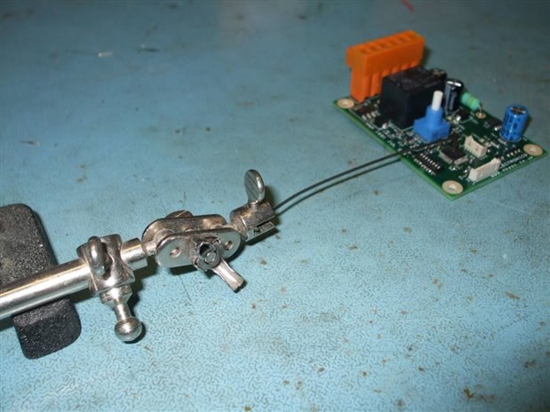

    A long time ago (about 1994) when I had multiple minions I got one to make me a similar device: a spring steel prong fixed to a round metal base. About 12 years ago when I left to work on my own one of my last acts was to scrounge some of the spring steel wire with which I made the thing in the picture. (The third hand thingy came from a car boot sale.)
    I don't use it so much now for small parts - I often tack one leg down (using the microscope to see what I'm doing) but I still use it for ICs with more than 8 legs.
    MK
