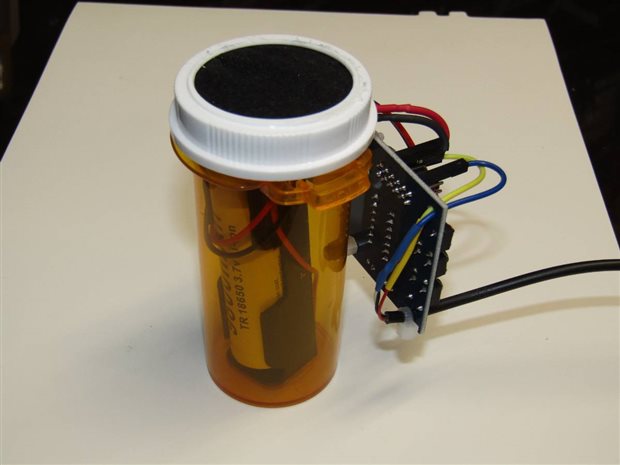

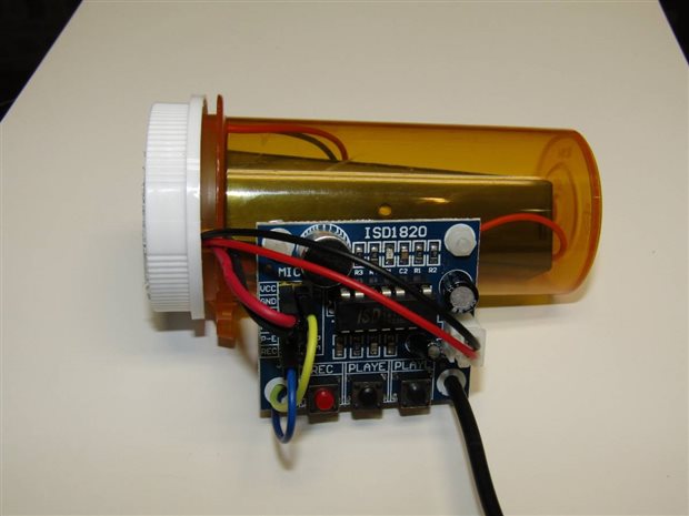

The heart of the Lie Detector is a small circuit that I have used many times in the past and just recently on my Electronic Art project "The Thinker". It is available on EBay for about $3 plus shipping.
https://www.ebay.com/itm/ISD1820-Voice-Recording-Playback-Module-Sound-Recorder-w-Speaker-US-Seller/114316359736?ssPageName=STRK%3AMEBIDX%3AIT&_trksid=p2057872.m2749.l2649
This circuit is powered with 3V to 5.5V and allows one to record up to 10 seconds of audio which can then be played back through the speaker as many times as needed. The sound reproduction is really fairly good but it is necessary to make some sort of a speaker enclosure otherwise a lot of fidelity is lost.

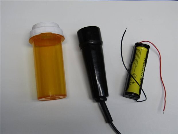

Here are the rest of the parts that I needed to make the Lie Detector.
Here we have a big medicine bottle, a 18650 battery in a single holder, and a handpiece from an X-Ray exposure cord. The Exposure cord is just a momentary push button switch in a handle that was originally used to take dental x-rays. This is what the dentist's assistant takes outside the room to avoid the ionizing radiation she is about to shoot through your mouth. From past experience I know that the medicine bottle makes an excellent speaker enclosure. The bottle is also big enough to hold the 18650 Li-ion battery and holder as well. There wasn't anything to the electronics on this project as the voice module came fully assembled and there was a header on the board where I could make the needed connections using female bread board jumpers. Here are some pictures of the finished project.

    I have several of those sound recorder PCBs and I do like them. If you repeatedly activate the play input you can get a sort of rap from them - depending on what you record of course. I haven't put the speaker in an enclosure before so I might try that the next time I use one.
