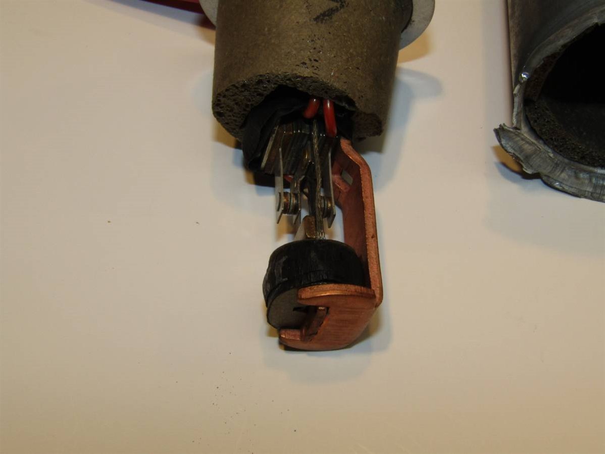

When I first tried to get this vibrator to work it would not start. Eventually I gave up on banging on it and got out the cutters and removed the case. The contacts were very badly surface corroded. It was as if they were coated several mils thick with a white oxide powder. I went to work with some fine sand paper and after about a half hour I finally had the contacts making good contact. I wanted to hook the vibrator up to a center tapped 6.3 volt secondary of a transformer and see what level of voltage would be generated on the primary of the transformer. Here are the internals of the vibrator: The black on the end closest to the bottom is a coil with one magnetic pole near the switch throw which can swing back and forth between the outer contacts.

The vibrator itself is a single pole double thrown switch with a center off position when it isn't powered. The coil of the vibrator sits across the power and one side of the switch. When power is applied the magnetic field of the vibrator coil causes it to deflect but as soon as it does the contacts energize one side or other of the center tapped transformer. The counter EMF of the transformer causes the coil to reverse polarity and jump back which causes the other side of the center tapped winding to be energized. This process continues for this unit at a rate of about 600 Hz output. The transformer which is usually 115 Volts primary and 6 volts center tapped secondary now takes the fluctuating 6 volts on either side of the center tapped secondary and transforms it to 200 volts plus on the primary winding.
