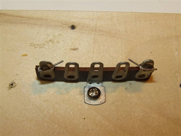

Here is where our little springs of solder come in. They are in fact not just solder but rather a copper core wire surrounded by solder and flux and shaped into a helical coil. I am going to replaced the old bad capacitor with a new one that came in the package with the coils of solder. The first step is to cut the leads of the bad component leaving a half centimeter of lead.
There is no need to try to desolder the original connections.
The coils of solder and wire are in place and the new capacitor is now inserted into the other sides of the coils.
Finally heat from the solder iron tip is applied to the coils until the solder melts and bonds with the wires.
The connection was easy to make and there is minimal disturbance to the rest of the connections in the terminal. Further the coil of internal wire satisfies the perceived need to have a very good mechanical connection. The added bonus for me was that for some reason the solder from 50 years ago smelled better than the current formulation so I was able to enjoy a whiff from the past.
