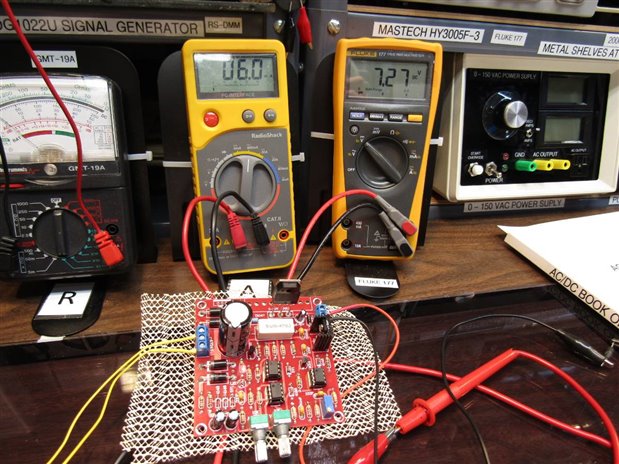

Here is a board that I assembled yesterday just to experiment with. This kit was a knock off of the original Hiland design and I paid $3.50 delivered to my door from Banggood in China. Everything included in the kit is of reasonable quality except the TL081 Op Amps. While they have a TI stamp on them they are definitely not TI. For one thing they lack a functional Offset Circuit. I usually throw away the ones that come with the kit and put in 3 genuine TL081 from TI. The small blue trimmer in the lower right hand corner is the Offset Adjust for the Voltage control Op Amp directly above it. This allows the board to be adjusted to zero volts output when the voltage control is turned all the way down. The board is designed for a 24 VAC input and with deliver 0 to 31 Volts DC output. Depending on how solid the 24 V AC source is the board will deliver 3 Amps output. The module can operate in a constant voltage mode as well as a constant current mode.
The purpose of my experimentation with the board last night was to see what could be done to zero the current when the current limit control is turned all the way down. As the unit sat on my bench it would not go below
6.0 mA.

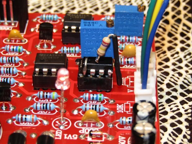

Over the years I have had several of these boards get damaged when my experiments went south. To assist with repair I have logged voltages for the unit when it is in the constant voltage mode (Black Notes) and when it is in the constant current mode (Red Notes). Since the voltage control TL081 had an offset trimmer I decided to see if a similar offset trimmer could be installed on the current control TL081. U3 is the current control TL081 and one can see from the schematic that the offset leads of the IC are not being used. I took a 100K trimmer and mounted it directly to the top of the TL081 and ran the trimmer wiper to the correct point on the circuit board. When the unit was powered up the current was at 13 mA but as soon as I began to adjust the trimmer it quickly came down and was able to be zeroed.
This made me very happy. Here is what the fix looked like:

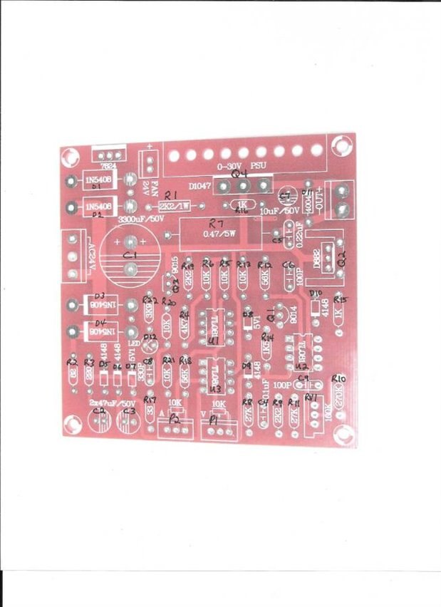

The PC board itself is good quality but it lacks reference numbers for the components. The values are marked for ease of assembly but if you need to service it or coordinate with the schematic this may be of help.
