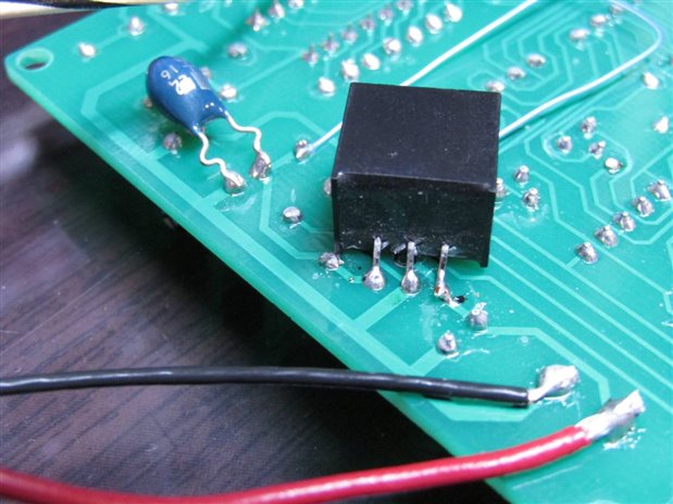

One thing of interest since last time is that I have solved the problem of where I was going to get the 5 volts to energize the relay that puts the clock into suspended animation. I remembered that while the clock itself has a Vin of 9 volts it was followed in the circuit by a 78L05 voltage regulator. This is a small TO-92 device and I didn't trust it to handle the power requirements of both the clock and the relay so I replaced it with another Recon R78E5.0-0.5 which is a 500 mA version DC to DC converter. Here is a picture of the reverse side of the clock module showing the installation of the DC to DC converter. Not surprisingly the current draw on the 9 volt line dropped considerably as the DC to DC converter is much more efficient than the linear 78L05.
By taking the image power for the suspension relay from the clock board I was left with only two control lines running from the Clock Module to the Interface Board. Pulling one to ground will turn on the clock itself and pulling the other one to ground will energize the relay and suspend the clock. I bread boarded the interface circuit and hooked it to the Clock Module. I manually simulated the control output of the Arduino and monitored the current drawn by the clock module.

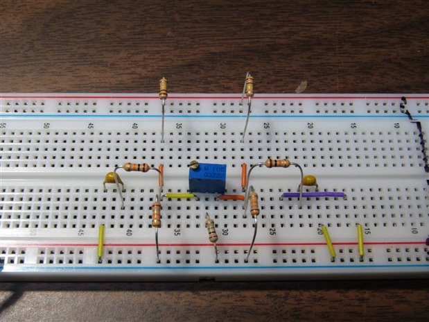

     The next interface that I needed to design was the one between the Test Voltage and the Arduino's analog input (0) and the one between the Target Voltage and the Arduino's analog input (1). Since the Arduino can handle a maximum 5 volts on these inputs and since my target and test voltages may be as high as 30 volts a resistor divider seemed to be indicated. Besides just making it a resistor divider I also wanted to put a little bit of averaging into the voltage delivered to the Analog inputs so that spikes and fluctuations would not cause problems. The last thing I wanted to do was to make an effort to balance the two voltage dividers so that the voltage received by the Arduino wasn't weighted in favor of the Test or Target voltages. I wanted to be able to do this without spending hours trying to match the resistors that I chose for the dividers. Here is the circuit that I designed, bread boarded and tested out.
And the Schematic to go along with it.
Since I am only a Technician and not an Engineer I have special permission to design empirically. The balancer with the 1 meg trimmer and center leg to ground through another 1 meg resistor was what it took to balance the two sides. No calculations needed. To test this I put the same 30 volts on the Target Vin and the Test Vin. I then put my millivolt meter between "To Analog (0)" and "To Analog (1)". I next adjusted the 1 meg trimmer until I had 0 volts on the meter. This told me that my voltage dividers would deliver the same voltage to analog (0) and (1) if the same voltage was provided at Target Vin and Test Vin.  To provide a little stability to the output voltage I have a 10K resistor supplying a 100 nF capacitor before it is sent to the Analog inputs.
     While I didn't include it in this discussion I will also have to have a connection point to tie the Volt Meters into the circuitry. Each volt meter will need a +9 volt feed, a ground and then the voltage sense line will go back to the Target and Test voltages. The present plan is to make an Arduino shield board that will contain the two interfaces as well as the meter connection points.
     If anyone can see anything that I have done in these interfaces that has "problem" written on it your input would be appreciated.

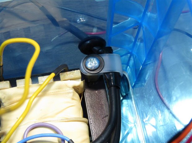

    Addendum: One of the better engineers on our e14 Forum has called my attention to the poor example that I set in providing an adequate strain relief for the power cord that comes into my project. He is…
    jw0752 over 8 years ago
    Addendum:
    One of the better engineers on our e14 Forum has called my attention to the poor example that I set in providing an adequate strain relief for the power cord that comes into my project. He is 100 % correct and with a constructive suggestion from him I have added a better strain relief. Often in our excitement to complete a project there is a temptation to take short cuts. Sometimes these short cuts are trivial but when we are dealing with mains power we should always do our best to do things according to the rules. Here is a revised photo of the way I have improved the strain relief on my power cord to the unit.
