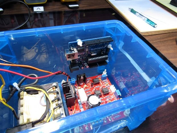

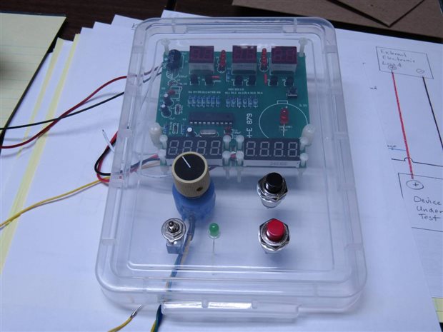

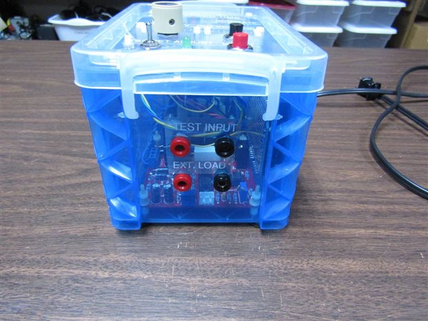

Now that I have a working prototype the next project will be to build the interfaces onto a shield that will mount to the Arduino and then connect it up to the rest of the systems. In the mean time I have completed the mechanics of mounting the switches, Clock and input jacks to the project enclosure. Here are a few pictures of the progress to date:
As you may have noticed in the second picture above the strain relief I was using was on the mains cord was not conventional nor adequate. I have since rectified this problem with a more sturdy and conventional anchor.
