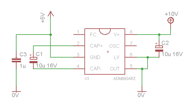

    I needed to do that recently for powering some analog circuitry (similar circuit but in voltage doubling mode, I needed a >9V supply from 5V),
    there is a lower-priced alternative which is pin-compatible, Analog Devices ADM660, and it has the benefit of higher output current.
    (I like the voltage doubling circuit, one of the few circuits where you apply the +ve supply to the GND pin of the IC!).
