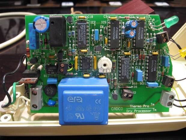

The complaint was that the unit would turn on and warm up to the 65 degrees C but when the BOIL button is pushed it fails to reach 100 degrees C and the READY light never comes on.
Step Two in the repair process: Try to understand the hardware that is being used to accomplish the goals of processing the material.
I opened the unit up and this is what I found on the inside:
Since the unit was partially working I plugged it in and began probing the circuit. The 8 Pin DIP just above the blue transformer is a TS272C CMOS Dual Op Amp. Exploration would show that this Op Amp was sensing the resistance of a Thermistor that was attached to the metal block. The thermistor was in fact tied to the non-inverting inputs of both sections of the dual Op Amp. One side of Op Amp was controlling the temperature regulation at the 65 degree C level and the other section controlled the temperature regulation at the 100 degree C level. Depending on which part of the cycle the unit was in the outputs from the Op Amps were selectively driving an SCR that was delivering half cycle line voltage to the small heater element embedded in the metal aluminum block. My measurements showed that Vdd for the dual Op Amp IC was 11 volts, The reference voltage for the 65 degree Op Amp was 5.6 volts and the reference voltage for the 100 degree Op Amp was 8.2 volts. Voltage from the Thermistor varied from 2.6 volts at room temperature to 8.2 volts at the 100 degree level.

Here is a closeup of the board. The white trimmer to the right of the Op Amp is used to calibrate the 65 degree reference voltage. You can see the thermistor leads entering through the hole in the board. To the far left we see part of the SCR and the PNP transistor that was being used to drive it. At this point I ran several more attempts to get the unit to cycle to 100 degrees and each one failed around 80 degrees C. Just for the fun of it I turned the board over to inspect the solder job. Experience told me that this was not likely the cause of my problem but it never hurts to check the solder joints for crystallization and besides it would give me some time to think.
The solder job was not impressive but I could not find anything wrong that would need resoldering and no indication of any other type of failure. The time spent inspecting the board with a loupe had not been totally wasted though. The brain had done its job and I now had a suspicion that my problem might lie with the Thermal protection switch. For a quick test I jumpered around the protection switch and pushed the BOIL button. I continued taking measurements of temperature on the metal block and voltages on Op Amp as the temperature climbed, 80C, 90C, and finally 100 degrees C. At this point the yellow LED began to flash and the temperature maintained for about five minutes. Then the little fan under the metal block came on and quickly brought the blocks temperature back to 65 degrees C and with a beep from a piezo speaker the READY LIGHT came on. Success!

    I wanted to delve into this circuit board further as I was fascinated by how they were using the Op Amps and I wanted to better understand how they were switching the Op amp outputs to the SCR. Unfortunately it is a two sided board with lots of very narrow traces running under components. It is also a fairly expensive piece of equipment and I didn't want to accidentaly unfix it while exploring. image

    Finding out what is wrong with a piece of equipment gets to be almost an obsession. My curiosity drives me until I figure it out. The outputs of the TS272C dual op amp go into the resistor arrays at either side of the chip and then it is very hard to follow. It seems to end up at the HEF4093 Quad 2-input NAND Schmitt trigger chip. A LOW output of the Op Amp turn on the SCR and a HIGH turns it off. The driver transistor of the SCR is a PNP which makes sense. The other chips on the board are an HEF4060B 14 stage ripple counter which is probably used to time out the amount of time the unit stays at 100 degrees C and 3 MM74C74 Dual D-Type Flip-Flops which are probably used to switch between the two temperatures and to control the fan and the sonalert. About all a person can practically do is speculate on how it works at this point.
