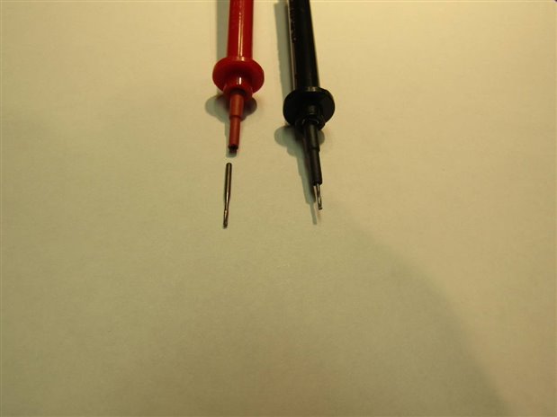

    I have continued to work on this idea and to refine it. The goals that I had for this iteration of the idea are to modify a set of meter test probes so that the probe itself has a friction chuck whereby I can insert and remove the dental bur tips without having to have the bulky adapter or for the need of an Allen wrench to change the bur. Here is a picture of the black probe that I am going to modify. Notice that the tip is removed by unscrewing it from the sheath. The screw thread is a standard 10-32 USA thread.

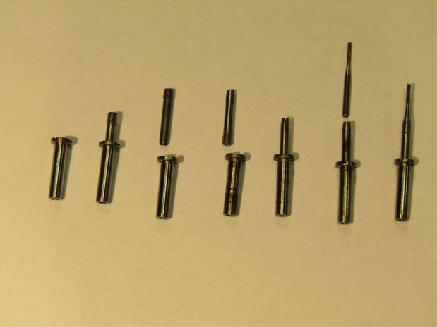

    I began by looking for a suitable friction grip chuck and mounting to replace the original point on the probe. The tips are dental burs and they are generally used to cut teeth in a dental drill so I went to my sons dental equipment repair shop and got some old parts from the mini turbines that are used in dental drills. Below I took a picture of a sequence of changes that I made to the parts called spindles and to the chuck which is inside the spindle. The picture on the left shows the spindle as it comes from the dental drill after the bearings and the turbine blades have been removed. In the second picture I have started to back the chuck out of the spindle with the chuck completely removed in the third step.  The fourth step shows the chuck flipped 180 degrees and screwed back into the spindle in number five. Since the threads do not continue very deep we hit a stop position. The final two pictures show the bur about to be inserted and then seated into the chuck.

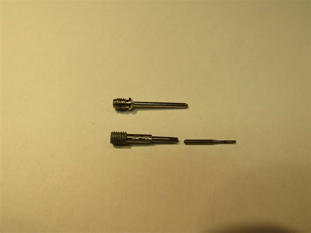

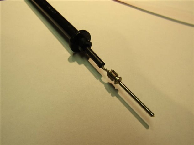

    The spindles come with a shoulder that will not be needed in the final construction so I will grind it off. Next I took a 10-32 screw and drilled a hole down the center of the screw and cut a section to slip over the chuck. Here is a picture of the spindle and chuck assembled with the screw threads compared to the original probe end.

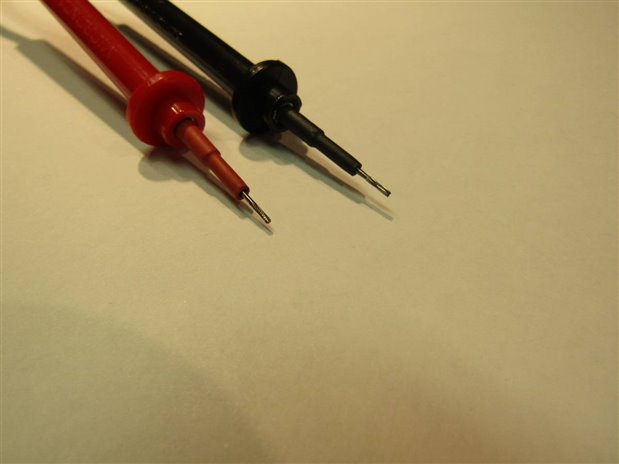

    In the final assembly the probe wire is soldered into the spindle and the unit is screwed back into the probe handle. The finishing touch is accomplished by adding some colored heat shrink. Here are what the finished probes with friction grip chucks for the probe tips looks like.

    DAB over 9 years ago in reply to jw0752
    Nice update John.
    mcb1 over 9 years ago in reply to jw0752
    That looks like a commercially made unit ...well done.
