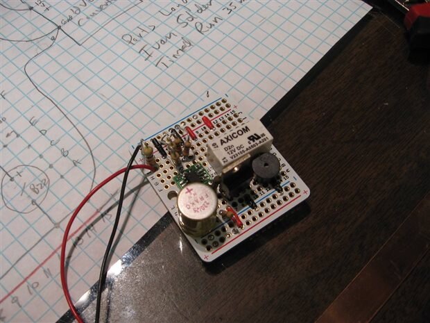

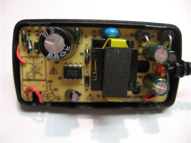

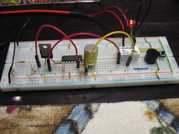

Here is one of our test circuits This first circuit used one section of an LM339 for a comparator of an RC timer circuit The final design will use a single  LM311MLM311M comparator The small sound module on the right side of the board is part of the discharge path of the capacitor This gives us a small beep every time the circuit shuts down The beep reminds us to turn the iron back on if we are still using it at the time One of the challenges of this project was how we were going to find a power supply for the timer small enough to fit into the case of the solder iron holder we planned to use The answer came when we decided to salvage a small 12 volt switching supply board from a wall wart power supply

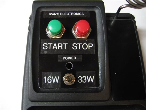

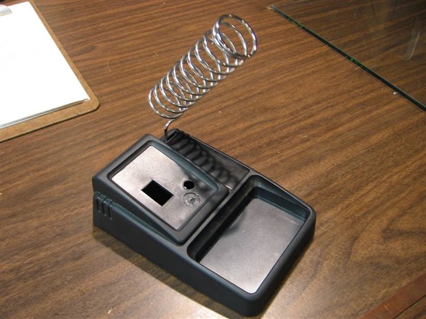

I did not want to deprive Ivan of any part of the design process but I decided that there was plenty of time for him to learn the details and I did not want to get bogged down trying to solve the problems we all know constantly crop up during the build process. At least in these early stages of his learning I wanted things to flow smoothly, more like assembly of a well designed kit. Therefore in the days between Ivan's visits I busied myself planning and preparing the parts so that the assembly would go smoothly. A new control panel fascia was made for the solder iron and the holes were positioned and drilled for the switches and indicator LED. With Ivan's help the controls were installed and the unit began to take shape.

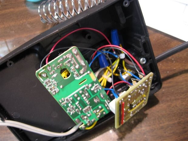

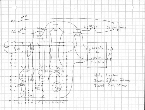

In the week leading up to Ivan coming today I continued to experiment with the circuit. I had originally hoped that the unit would have zero current draw in the off position but in the end the only way I could assure that we had the space for needed components was to leave the wall wart, 12 volt power supply, on and waiting for use. This would mean that the unit would draw 2 mA in the off mode just as most wall warts do when plugged in but not in use. While this doesn't sit perfectly well with my old fashioned idea that off should mean really off I guess that because so much of the appliances around me are really never truly off, I have gotten more used to the idea. When Ivan arrived today we got right down to business and began to assemble the the timer board which is the heart of the unit. Here is the schematic and circuit board layout that we used.
Ivan looked at the bread board with all its components and asked if all those parts were really going to fit on the small Adafruit  board we were going to use. I explained that this is why it is important to make a good plan before starting. We began to prepare for soldering by teaching and reminding Ivan about some techniques for handling the iron and cleaning the tip. In the process we managed to give him his first "Solder Iron Burn". We ran cold water on it and put a band aid on it and all he seemed concerned with was getting back to work. Little by little we assembled the board, all the while discussing the components that were being used and what they do. Here is the completed board.
The next step was to wire the assembled board, the power supply, and the switches together and fit them into the base of the solder iron.

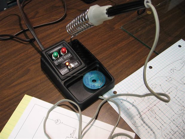

     With the unit finally assembled I explained to Ivan that we would probably be disappointed and we would likely have to take the unit apart again and find a mistake or two as this is my usual procedure.
He was eager to try it out so here he is pushing the START button for the first time.
     image image
The power light came on, I was pleased. The Stop button worked, as did the 16W / 35W switch. Now it was just a matter of turning it on and waiting approximately 35 minutes for it to turn itself off. Ivan and I busied ourselves with cleaning the bench and putting away the tools while we waited. As the time got close I became concerned as it was almost time for Ivan to go home and I didn't want him to leave with a failure hanging over us. Finally there was the small beep of the discharging capacitor and the power light went out.
