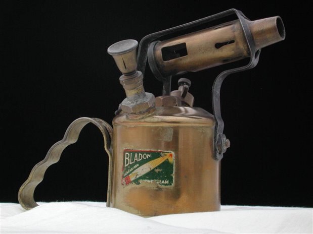

    Hi John,
    You can make a light tent using just about any white translucent cloth to act as a diffuser to produce soft light which wraps around the subject. This blow lamp was done with an upturned chair with a white bed sheet thrown over the chair legs
    Using paper or aluminium foil as a 'bounce' reflector will help as well.
