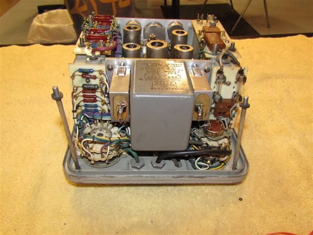

Last night I had a wonderful time as I took it apart and inspected it as I cleaned it. The outer case was so dirty the only fix was to remove it and scrub it in the sink with 409, soft scrub, and hot water. Here is what the meter looks like on the inside:
According to the army manual there are no electrolytics used in the unit. The tubes are all designed to be used at sub specification heater currents so they last longer. In the day, all parts were standard and easily replaceable in emergencies. If you look closely you can see a single fuse type clip on either side of the transformer. These clips hold spare germanium diodes. I cleaned the face of the unit of dirt but fortunately the seals had been good, the rubber was still soft, and the internal electronics were as clean as the day they were assembled. I plugged the unit in and turned it on. The glow of the #47 pilot light and the faint glow from the *** on the top of the tubes was reassuring.
