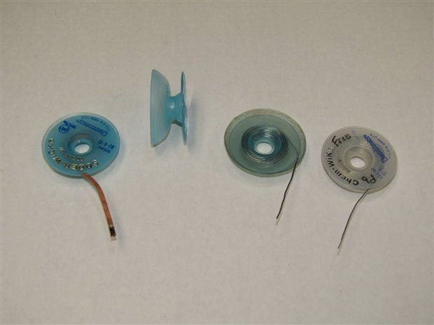

Reusable Solder Dispensers
            You may recognize these as the containers on which solder wick is supplied. Solder wick is a copper braided tape that has flux embedded in the mesh. When a technician wants to remove the solder from a joint the braid is placed on the joint and heated from the back by the solder iron. As the solder melts it has an adhesive affinity for the copper, enhanced by the capillary action of the mesh and it is sucked into the braid and away from the original joint. Once a piece of solder wick has become saturated with solder it is no longer useful and it is cut off and put with the metal recycling waste.
            When the wick is all gone we are left with a nifty little plastic holder. The second item in the picture above shows how the plastic holder can be opened up. If you have a larger spool of solder you can wind solder onto the plastic holder and fold the outer plastic cover back into place. This makes a very convenient package to hold and use while soldering. It has the advantage of protecting the solder from the environment as well as oils and chemicals that might be on your hands. The solder is less likely to oxidize inside the holder. From your perspective you do not have to touch the solder and worry about any heavy metal contamination. The little plastic holders can be reused many times before they crack and fail. The dispenser on the right is stocked with lead free solder and so the container was marked Pb (Lead) Free.
            As a builder technician it is wise to always be watching for material resources. These solder wick dispensers, which are usually just thrown away, actually have a great second purpose and can continue to serve you for years as solder dispensers.
