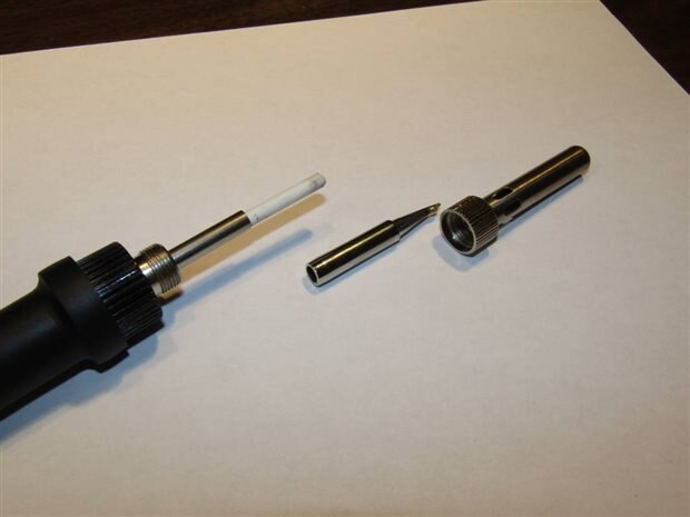

The unit is designed with a small ceramic heater that converts 60 Watts of power and is small enough to fit inside a 4 mm diameter cavity in the base of the tip. Since the heater is so integral with the tip the heat up time is extremely fast and the ability to respond to demands for heat from large traces and pads is very good. Warm up from room temperature to operational temperature is roughly 30 seconds. Here is a close-up picture of the handpiece.

    There are a few tips available for this iron and they are pretty cheap too. My only complaint with the Tenma is that the stand seems not quite right. I always feel that the iron is going to fall backwards…

    Hi Rachael, You are very correct. The grip to tip distance is what make the difference. I ordered up some additional tips as soon as I finished my first soldering session with the unit. I was surprised…

    Regarding the overall length, the more important difference between your old iron and the new one is the "grip to tip" distance? I suspect the additional length and then some of your old one was likely all in the hot section. The shorter the grip to tip distance the easier it is for fine work.
    Do you have (or plan to get) a selection of tips for this? It looks like a fairly small tip which is good for most normal components and regular SMT parts. If you want to solder things like connectors or anything which has a large plane attached then you might want to swap the tip for a larger one for those jobs. Then there are really fine ones if you get adventurous with fine pitch SMT stuff! image

    You are very correct. The grip to tip distance is what make the difference. I ordered up some additional tips as soon as I finished my first soldering session with the unit. I was surprised how similar the different tips were. Only the extreme sizes showed a visual difference. The smaller conical and chisel sizes are indistinguishable. I actually thought that there had been a packaging error and 3 of the tips were the same with different stock numbers. I am sure I will use them and they are in a size that will likely be the most used.
