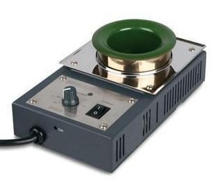

    Now all you need is a solder pot - you already have the solder ingots.

    jw0752 over 7 years ago in reply to dougw
    Hi Doug,
    Actually I have never used a solder pot and so I did a little research to see how I might use one. My research concludes that it would probably not get enough use to justify it but it was fun to learn about them.
