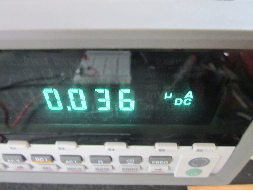

    You got me wondering what the off leakage was and how long your batteries would last. Simple way to find out was to try it. This is the 'off' supply current with a 2N5060. [Sorry that the picture isn't very good - it's hard to get good pictures of the display on the Fluke with its reflective surface.] 36nA isn't much.

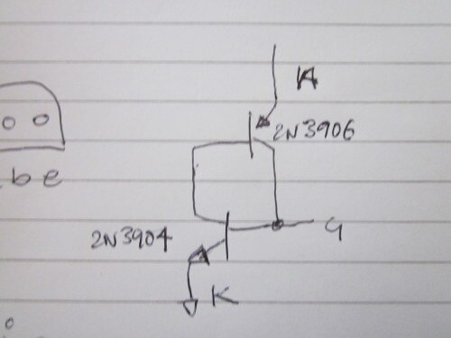

    Then I wondered how that would compare with building the SCR out of two transistors like this

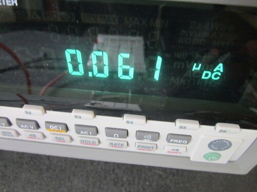

    in this case, the off supply current was 61nA
    So the SCR is better ["Hurrah for the SCR!"], though I don't think either would tax your batteries too much.

    I was wrong.
    The breadboard had capacitors on the supply rail from a previous experiment and I left them in place. There was an 10uF electrolytic and a 100n ceramic.
    By itself, the electrolytic measures 29nA for leakage, and the ceramic 1nA (maybe), so combined they give about 30nA.
    That means the SCR was really about 6nA and the transistor version 31nA, so there was a fair difference between the two.
    Not that it makes any difference to you - the readings are so low that they are quite insignificant compared to the self-discharge rate of the batteries; it's the flashing LED that will do for the cells.
