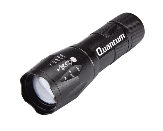

I had been gathering potential materials and making and discarding ideas for about a week before I started the actual build. The flashlight that I had decided to use was an LED type sold by Harbor Freight and cost $10.00.
This is a beautiful little flashlight with Zoom focus of the beam and three light settings, Bright, Dim, and Strobe. It does however have a dark side. It is powered by 4 AAA batteries (6 volts) and my tests show that when the flashlight in on the bright beam and powered by 6 volts it draws 1.5 Amps. Anyone familiar with AAA batteries knows that 1.5 amps is not a sustainable current for these small batteries. Since I did not want the flashlight to die during one of my walks and I certainly did not want to be buying AAA batteries frequently I would have to find an alternate power source.

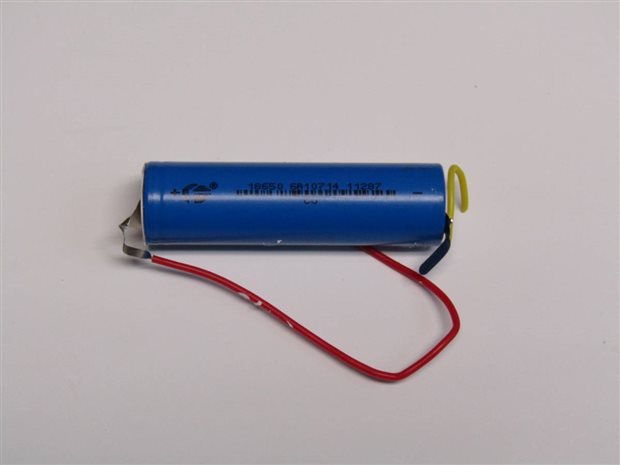

The ideal power source would be a lithium ion battery that could handle the 1.5 amps for a reasonable time as well as being rechargeable. I decided to use a couple 18650 cells that I had salvaged from a laptop battery pack. The two Lithium batteries in series would give me a nominal 7.4 volts which would be too high for use on the flashlight. I would have to have a way to bring the voltage down using a DC to DC converter. In the meantime I had performed additional experiments on the flashlight and I found that by using 5 volts the light output of the flashlight was still excellent and the amperage had dropped to 1 Amp.

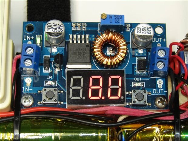

I experimented with various voltage regulators and circuits before I decided to use a nice adjustable circuit with a digital voltage readout. This was a circuit board that I bought off the Chinese market a while back. It has an offset of 1.2 volts and can handle 5 amps of output current.
The circuit has 2 key switches that allow me to turn the display on or off and I can choose to monitor the input or output voltage. In the picture above the circuit is monitoring the 8 volt input voltage of the 2 Lithium batteries.

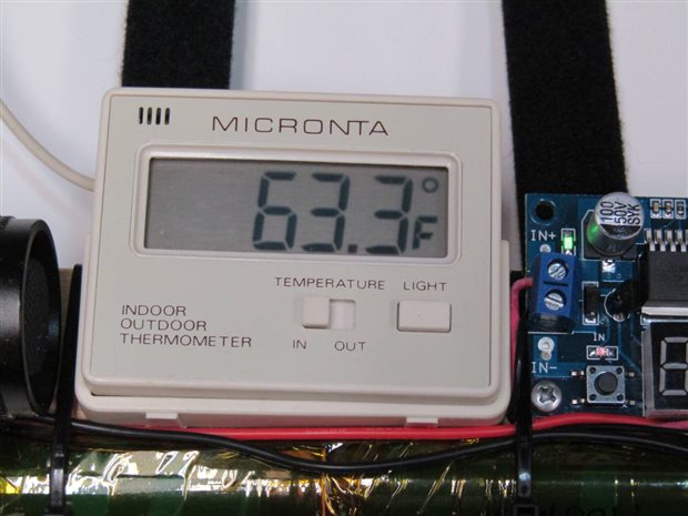

Since the voice activated flashlight was starting to look very techy I decided it would not hurt to add one more feature, an indoor / outdoor thermometer. I could use the indoor side of the thermometer to read the outside temperature as I walk. Here in Wisconsin in the Winter this can range from 32 F (0 C) to -20 F (-29 C). It actually gets colder than this but even with good winter gear temperatures below -20 F are too dangerous to walk just for the sake of it.
All my life I have suffered with my feet getting too cold in the winter. As a kid I would often suffer from chilblains after coming in from play. Now I have some really good boots but still the potential is there for this painful condition or even worse the prospect of frost bite. If I thread the outdoor sensor of the Indoor / outdoor thermometer into the toe area of my boot I will be able to monitor just how cold my toes are getting and I will be able to take some remedial action (like calling the wife to come a rescue me) before things get too bad.

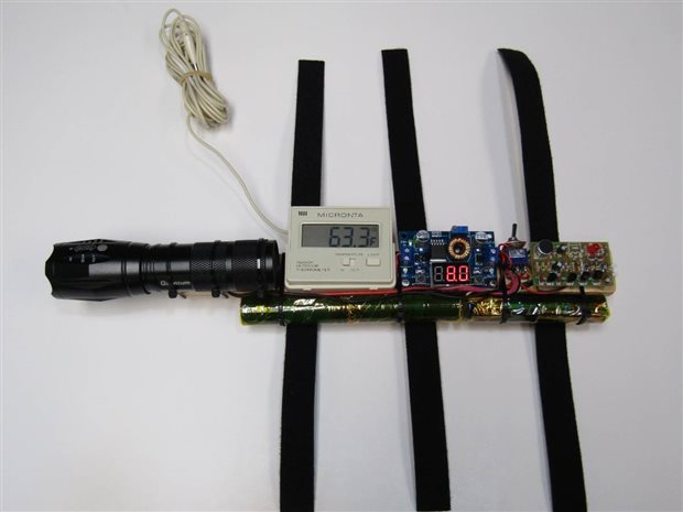

The next step was to put it all together and build the wrist mounted, voice activated flashlight, with thermometer. This is what the finished first prototype looks like:
I am using velcro straps to hold the unit to my right arm. When strapped into place it positions quite well and allows me nearly full use of my right hand. I can bring the unit within a foot of my mouth and turn the flashlight on or off with a voice command or more dependably, because of my weak voice, a click of my tongue. I have made a video of how the unit works and in the video you will see it ignore one of my voice commands to turn off. I would have redone the video but my videographer (wife) had to leave and so you will get to see an honest demo video. It appears in the video that I am telling the device to turn on the bright, dim, and strobe features of the flashlight but these features are cyclical and I am just telling it to do what it is automatically going to do anyway. Here is the demo video:

Both my wife and my daughter were quick to point out that when it is strapped to my arm it looks like a gun. This perception will be even more pronounced as I walk through the darkened streets of my city. Someone will call the cops on me an when they pull up and surround me with their guns pointed I will stand there with my flashlight and my hands in the air. They will tell me to drop the weapon but since it is velcroed to my arm I will not be able to. My poor voice will not be loud enough for them to hear my screams of Flashlight! Flashlight! over the noise from their patrol cars. When I do not comply and drop my flashlight there will be a hail of gun fire and I won't be able to bore you with any more of my curious builds. It seems that I have designed myself into a corner.
When I have time I think I will down size the idea and use a smaller flashlight, get rid of the need for a DC to DC switching convertor, lithium batteries and the thermometer will also have to go. If I can get the Clap Switch to run on the flashlight batteries it is possible that I will be able to make a unit that is small enough to still be useful and not get me into trouble with the law.
