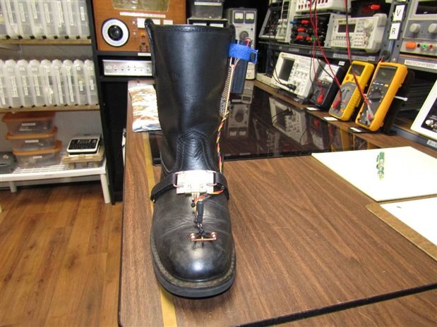

Today as I reflected on my near fall I decided to design something to make my walks a little safer. To this end I give you "THE BOOT HEADLIGHT"
The boot headlight is more than just a flashlight attached to my boot. It also has a photo-resistor and a comparator so that it is only on when I am in dark areas where the holes and cracks of the sidewalk are not visible. As soon as I step in the light of a street light or as I walk through the downtown area the boot light stays off. The low angle of the light mounted on the boot makes raised parts of the sidewalk show in high contrast. The raised edges that face me as I walk show a bright lines across the path and the edges that face way from me show as shadows. On my test walk tonight, the Boot Headlight worked well and made it easy to avoid dangerous obstacles.
Here is the simple schematic for the boot headlight and a closeup of the circuit board and battery strapped to the boot with a velcro band.
The quiescent power drain is 2 mA which rises to 4 mA when the LEDs are lit. I will be taking note of how long I can use it before the battery has to be replaced. While I have put the unit on my boot it could also be strapped to a leg or a belt, though I really like the low angle effect of the light on the sidewalk hazards when it is on the boot..

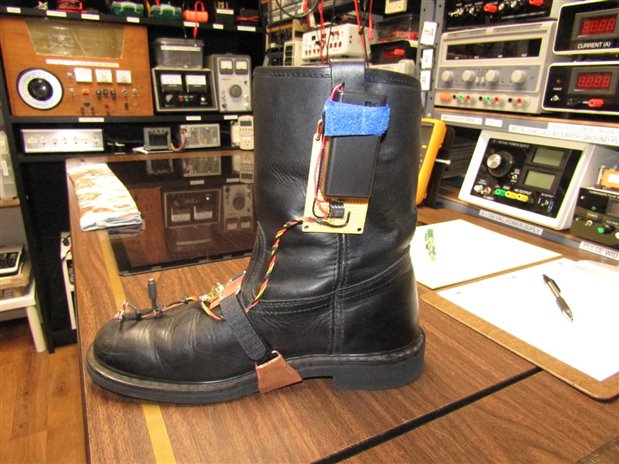

    Hi Everyone,
    I thought I would post an update on this blog. I am now approaching 2 months and about 35 hours of walking with the Boot Light. I am still on the first 9 Volt battery which is totally amazing to me. The battery currently reads about 8 Volts and I expect the light can function down to 6 volts before the dropout will affect the light intensity.
    The one problem that has continued to bother me is the difficulty I have attaching and positioning the original prototype unit on my pants leg. Last night I tackled the problem by building a new prototype that would attach to the boot itself. This should allow me to make a more solid and repeatable mounting of the unit. Furthermore I can take off the boot and mount the Boot Light and then put the boot back on. Here are a few pictures of the new prototype.
    I tried to make a video of how it works but my camera doesn't handle the low light well enough to show anything.
    I hope to get out later tonight and give the new unit a good 5 mile test.
