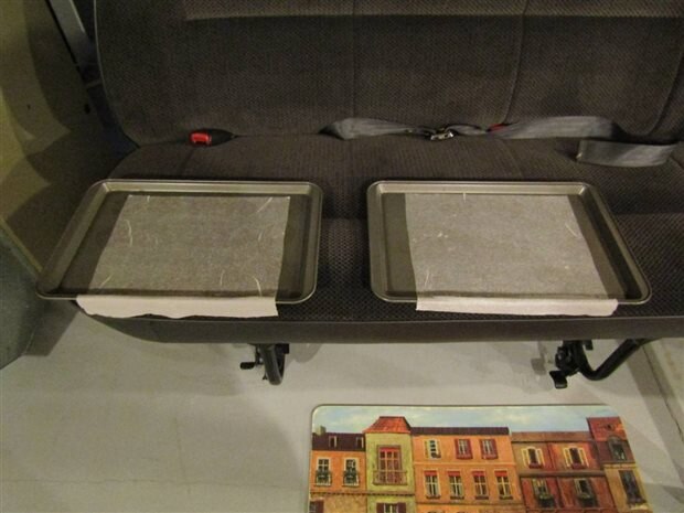

I wanted something similar that could be laid out on the floor in critical locations and would detect water quickly and definitely. The moisture detector relies on the conductivity of water which has a very uncertain resistance depending on levels of contamination. Since I would have no way to predetermine the resistance of any leaking water I decided to produce my own contamination in the form of salt. The idea is to have two copper electrodes wrapped in absorbent paper towels some of which has been soaked in salty water and then dried.
Here are two sheets of paper towels that have been soaked in salty water and are now being allowed to completely dry. The next step is to make the copper electrodes for the sensor. Short pieces of 18 Gauge copper wire were cut and wire pigtails were attached.
