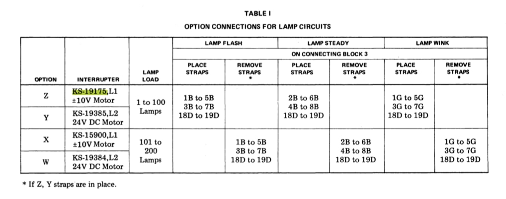

    Hello John,
    you are right the interrupter you have shown (very nice I should say) is part of a key system where the interrupter(s) role was just to manage the blinking sequences of light related to the lines (internal and external lines) calling, on hold and so on.
    Below: how to connect the KSU interrupter for different lamp flashing codes
