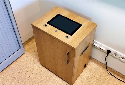

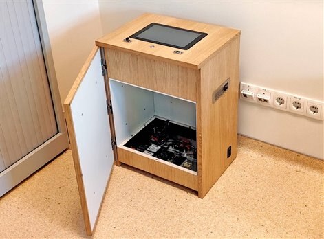

Everything was made by me, box, electronics, only sensor and x-ray source (well, and tablet obviously) was outsourced from eBay image (lucky find) Box was designed in SolidWorks and made from MDF board covered with oak.
All internal surfaces was covered by 2mm powder coated aluminum sheets as well as 0.5mm lead shielding. In reality due to physics how x-ray  are produced,only scattering will go sideways, 2mm+ 0.5mm for shielding  for 35kev energy is just too much. No radiation was detected outside the box, great news ! Also X-ray generator was using only 20W of power, and this is special kind of tube, where is no filament, I don't exactly know how it works. What is good that is 50um spot size. This is perfect match for Hamamatsu C9732DK-11 Sensor :

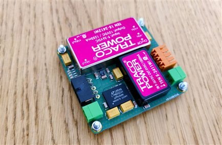

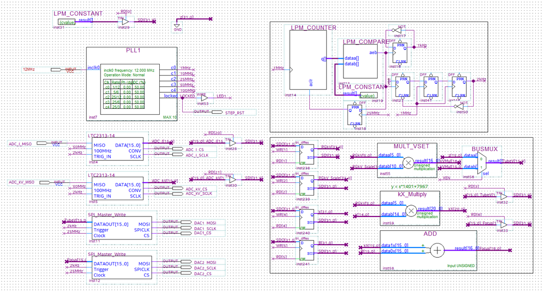

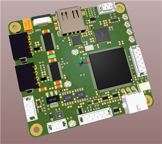

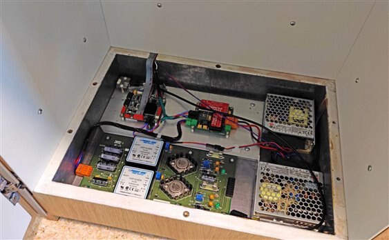

This that first project that used FPGA. I want to learn how to create custom electronics with it, and hardware for me is not a problem. I made boards with 800pin FPGA's for other to program image All programming is done via schematic implementation, so no need to write code, just place parts from libraries to form SPI shift register or do some basic math to scale register value to nonlinear voltage that x-ray generator is using for energy set-point. Power supply is generated from 24V, i need 5V 5A for Hamamatsu sensor, isolated +12,-12,+5V for X-ray generator, and another 12V for controller board as well as stepper drivers.
And here is how it looks all inside machine imageimageimage
Programming is done on Intel 10M08SAE144C8G FPGAimageimage
This is how part of program looks like image Not very exiting, and not very complex, just data registers, shift registers, MAC, comparators, triggers, gates, tri-bus drivers and so on image
