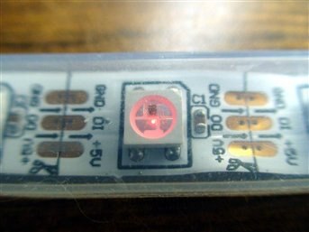

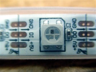

I'm working to design and build a controller for RGB LED strips, like the one shown in Figure 1.  This particular product comes in reels, 4m long, 60 devices per meter.  Each device contains a high intensity red, green and blue LED and a WS2811 controller chip.  See Figure 2 for a close up of the device package.

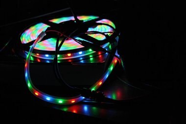

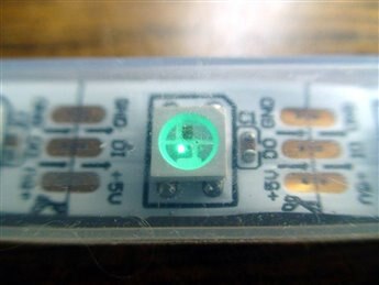

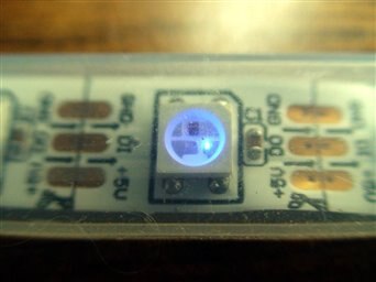

So far I have generated several static illumination patterns, including minimum brightness red, green and blue, maximum brightness red, green and blue, white light and others.  Photos of minimum brightness red, green and blue illuminations are shown in Figures 3, 4,and 5.
