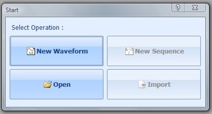

After starting Benchlink, select New Waveform:

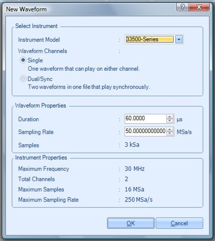

Then, in the New Waveform dialogue, set up a single channel waveform with a 60 μs duration (2.5 μs/bit X 24 bit = 60 μs).

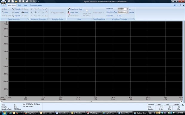

A blank waveform creation screen pops up.  This is where a graphic of the desired waveform pattern will be built.

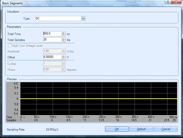

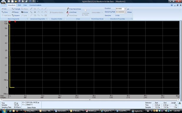

The pattern for the first LED is seven logic 0 pulses followed by a logic 1 pulse.  I'll build a single logic 0 pulse, then use cut and paste to duplicate six more and tack on a logic 1 at the end of this sequence.  First, select DC from the Waveform tab, then select a 500 ns duration with a +6.0 V offset.
The result will be a short piece of +6.0 VDC on the overall waveform builder view.  Returning to the DC segment dialogue, I'll add 2.0 μs of 0.0 V at the end of the waveform.  A single logic 0 pulse is thus described.

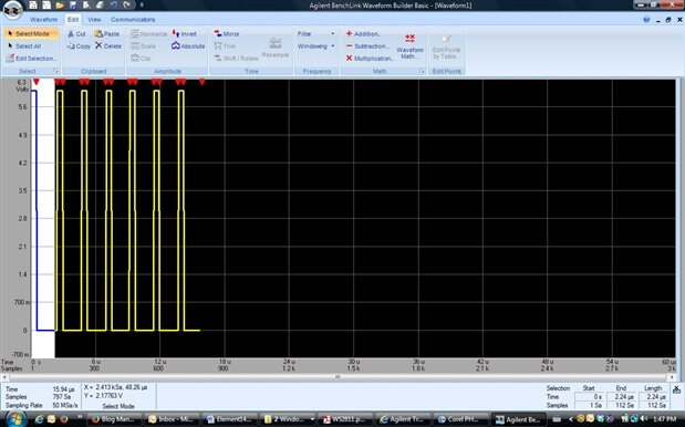

Using copy and paste tools, make six more logic 0 pulses.  The waveform now looks like this:

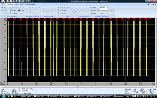

Again, using the DC component from the waveform tab, build a single logic 1 pulse with information from the timing parameters table above, then copy and paste in 16 logic 0 pulses to turn off the other two LEDs in the device. The full 24 bit pattern looks like this:

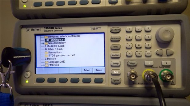

For this example, I saved the waveform, called "LED 1 minimum" to a USB memory stick and moved the stick over to the front panel USB socket on the Agilent 33522B.  The photo below shows the USB thumb drive inserted into the 33522B.  From the front panel I selected "Waveforms" then on the soft key menu, selected ARB, then Arbs (seems redundant, but that is the correct sequence), then "Select Arb", which brings up a file listing of the USB memory stick.  With the desired filename selected, press Select, and the file loads into the Agilent 33522B.
There is now one copy of the pulse train that illuminates the first LED at minimum brightness in the memory of the 33522B.  Using the Burst output mode, that single copy can be repeated any number of times to light up more LEDs in the string.  I have 4 m long strings, each with 60 devices/m.  That makes for 240 devices/string.  Two strings together makes 480 devices.  Let's start with a burst of 10 copies.  That should light up exactly the first 10 devices in the string.  The video below shows the bench set up including the various instruments used to observe system behaviour.
Finally, for this blog entry, the video below shows the 33522B being triggered to produce 10 copies of the LED 1 minimum waveform.  That lights up the first 10 devices in the string with minimum illumination on the first LED in each device.  Turns out the first LED in each device is a green LED, not a RED LED, so the WS2811 spec needs to be interpreted carefully, based on how the device manufacturer set up their devices.
