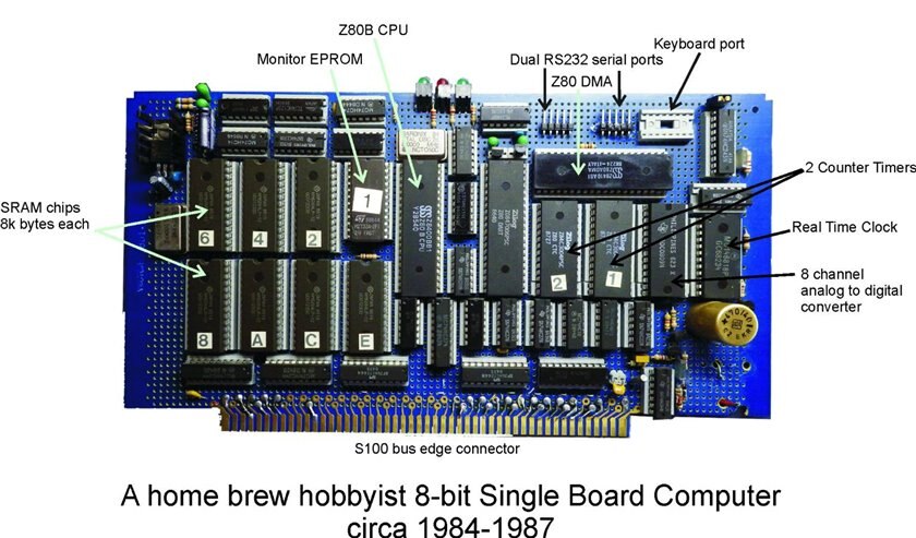

My hobbyist days began in the late 1970's, about the same time Bill Gates got interested in personal computing.  I thought the best way to learn about digital electronics and microprocessors would be to design and build a personal computer.  So I did.  I selected the Z80 CPU as the basis of my computer and the S100 bus as the form factor and backbone architecture.  After spending many hours designing a complete computer system on paper, I set to work building the hardware.  Using a vector board and a neat prototyping system of point-to-point IC sockets with punch down wiring made by 3M, I built the single board computer shown in the photograph below.
The date stamps on the ICs range from 1984 to 1987.  The board is intact except for a button cell battery holder that was removed from the lower right corner.  The button cell provided standby power for the Real Time Clock (RTC) chip.  Most everything that is on this board now fits easily in your everyday garden variety micro-controller from any manufacturer you care to name.
My skills grew enormously through the toil I put into this project.  I learned about signal integrity, timing, loading, buffering, clock distribution, power supply filtering, serial data communication, parallel data communication, memory mapping, address decoding, register maps, real time clocks, direct memory access (DMA), counter timer circuits (CTCs), universal asynchronous receiver transmitters (UARTs), erasable programmable read only memory (EPROM) and about firmware.

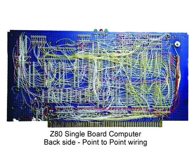

If you look at the back side of the board (below), you will see that I also learned patience, discipline and wiring layout.  Note that every single one of those 30 AWG wires is correctly placed.  Every feature designed into this board worked - by the time I was done troubleshooting; perhaps the most important skill I acquired by devising my own personal computer.

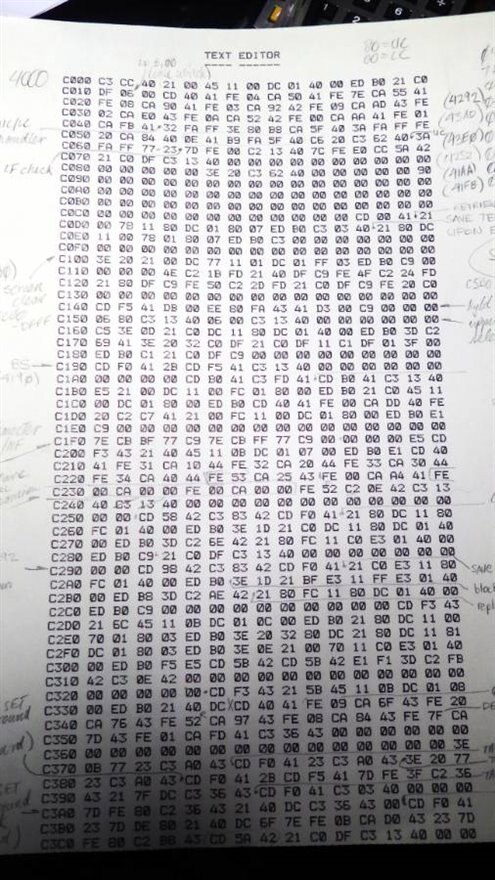

All of the firmware that animated my hardware creations was written in machine language.  Not assembly language, C or Python script, but in machine language.  I couldn't afford an assembler and a BASIC compiler was out of the question, so I learned to program microprocessors and embedded hardware in Z80 machine language.  Below is the first page of the machine code I wrote to make a basic text editor.  My programs were stored on cassette tape and backed up on paper.  The only permanent semiconductor storage I had on the board was an 8k byte ultraviolet erasable PROM.  Changing the contents of that chip meant taking it out of its socket, putting it in an ultraviolet eraser for 15 minutes, then moving it to the programmer (commonly referred to by the misnomer "blaster" - nothing ever blew up when I used it), blasting code into it and moving it back to its home on the CPU board.  Cassette tape storage was much more convenient.  The cassette tapes were long ago lost or erased. Any that may have survived at the bottom of a drawer have deteriorated into a useless state - and where would I find a cassette player to play them?  The paper copy on the other hand is intact and readable, over 30 years after it was generated, without the use of any extra-human technology.  Hmm, I feel my inner Luddite stirring.

    Augh!  Wire-wrap and sockets (and yes, wire-wrapped sockets) with a S100 bus!  Pardon me while I have a shuddering flash-back.  My first thought was that the S100 board (shown above) violated a number of spacing guidelines for heat disappation (instructor back then was a retired USMC Drill Instructor and less-than-optimal spacing was a sure-fire way of failing his course).  Final lab for a class back then involved using touch circuits to control lights and dial a phone (by pulsing a relay).
