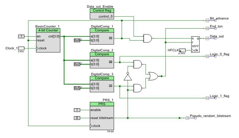

Because the PSoC 4 contains a nice programmable mixed signal hardware resource, I decided to see if I could use digital hardware to offload the bit timing task from the firmware.  The approach I took was the first that occurred to me, so it may lack elegance, but it was dead easy to implement and it works.  The idea was to design digital hardware that would accept a stream of binary bits and have the hardware convert the bits into correctly timed pulses acceptable to WS2812 RGB LEDs.  I selected the 800 kHz timing parameters from the WS2812 spec sheet.  The base clock source in my design is 8 MHz which means each WS2812 logic 0 and logic 1 pulse is composed of ten 125 ns segments, some at +5 VDC, others at 0 VDC.  A logic 0 pulse starts with three 125 ns segments at +5 V followed by 7 125 ns segments at 0 V.  A logic 1 pulse starts with six 125 ns segments at +5 V followed by 4 segments at 0 V.
To achieve the two timing structures for logic 0 and logic 1 I used the Basic_Counter component in PSoC Creator then adjusted its parameters to make it a 4-bit up counter.  On the output of this 4-bit counter I attached three 4-bit digital comparators.  One detects equality with a value of 9.  The output of this comparator is used to reset the 4-bit counter, making it behave as a 0 to 9 decimal counter.  This comparator also advances the pseudo random bit generator - more on this element later.
Two other 4-bit digital comparators watch the output of the decimal counter for the values 2 and 5.  The 2 comparator is used to mark the end of a logic 0's high time. Counting form 0 to 2 will mark off three 125 ns segments.  The 5 comparator is used to mark the end of a logic 1's high time.  Counting from 0 to 5 will mark off six 125 ns segments.
A clocked SR latch at the output of the bit timing generator is the final element that forms the output wave shape to drive the WS2812 LED string.  At the start of every new bit, the SR latch is set.  At a later time, either 3 x 125 ns or 6 x 125 ns, the SR latch is reset by one of the edges emerging from the 2 or 5 comparators.  The specific edge that resets the SR latch is determined by the bit value entering a 2:1 multiplexer connected to the two comparator outputs.
In order to avoid having to code a bit pattern generator in firmware, for my initial tests I decided to use the Pseudo Random Sequence (PRS) function in the Creator component library.  This component is a fully configurable Linear Feedback Shift Register (LFSR) that can generate short or very long pseudo random bit sequences.  Perfect for creating a random color sequence to test my bit timing engine design.  Because the LED strings I'm using have 240 LEDs and each LED takes 24 bits to describe a color, I wanted an LFSR that could generate at least 5760 pseudo random bits before repeating. A 13-bit LFSR can generate an 8191 bit sequence, and a 14-bit can generate a 16,383 bit sequence before repeating.  I played with both.
The schematic for the bit timing generator logic is shown below.
To allow firmware control of the bit timing generator I added the Data_Out_Enable control bit near the top centre of the schematic.  The value of this firmware controlled bit determines if the SR output latch is set regularly by the 800 kHz up counter, or if it remains stuck at logic 0.  If this control bit were not available, the color pattern on the LED string would never change.  The 240 LEDs in the string would fill with pseudo random values then all following bits would fall off the end of the last LED into the proverbial "bit bucket" (Where does information that falls off the end of digital circuits go?).  By inserting logic 0 intervals of at least 50 μs every once in a while I can be assured the string will reset and accept a new pattern of pseudo random values. Timing of the Data_Out_Enable control bit is managed with the following C code.

The video clip below illustrates the behavior generated by the hardware and firmware described above once the two are compiled and downloaded to the Cypress PSoC 4 Pioneer kit.
Finally, here is a screen capture of all the digital signals created by the logic shown above.  Compare the Pseudo_rnd_bits trace with the Data_out trace.  The logic levels arriving from the Pseudo Random Sequence component are converted into timed pulses by the logic to drive the LED strings.  A photo of the Pioneer board with all the logic analyzer connections is also included below.
