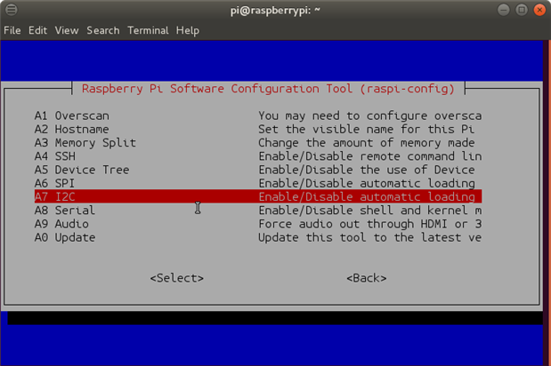

Boot Setup
I ran
sudo raspi-config
and selected option 9 - Advanced Options
Then I selected
A7 I2C
I selected <Yes> on the next page indicating that I would like to enable ARM I2C
On the following page I was simply presented with an OK prompt, which I selected by hitting the enter key.
I selected <Yes> on the subsequent page indicating that I would like the module loaded at boot time.
I then exited the raspi-config screen indicating that I would like to reboot.
