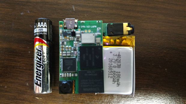

This thing is tiny, so tiny in fact, I had some issues connecting the battery to the daughter board. But nothing a pair of tweezers and a little patience couldn't resolve.
The above picture shows the kit assembled. With the WaRP7 connected to the daughter board. Yes, that is a AAA battery.

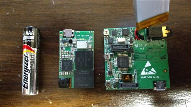

This picture shows the 2 pieces separated.
