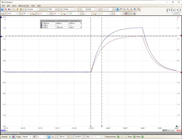

In all the scope traces that follow the blue trace is the voltage (on TP1) and the red trace is the current monitor output on TP3.
1.2A pulse into 8.24R load, 2R current sense, relay code = 16

There's more to measure (like with inductive and capacitive loads) - but so far it looks OK.
Next thing is to write lots of code for the real processor !
