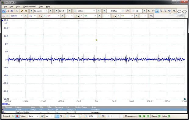

My noise looked like this when I had added a 470nF capacitor across the scope, about 4mV pk-pk and
325uV RMS (the HP spec is 500uV and 3mV pk-pk).
So I might have been happy except that I don't believe that periodic stuff is really coming out of a linear
power supply. So I turned the HP off at the mains and got this:
My conclusion is that I'm not really measuring the power supply noise at all - I only fitted the 470nF cap to
see if the spiky stuff would go away (it's a lot worse without the cap). My guess is that the noise is picked
up in the cables and that the psu is quite a high impedance at MHz+ frequencies. The noise is obviously
quite low - just can't tell how low without a different set up.
