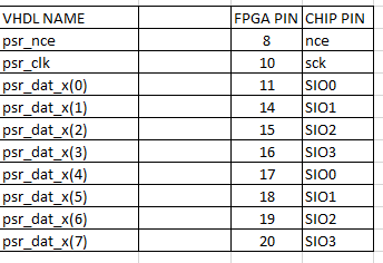

In the last blog about this board, I talked a little about the PSRAM chips. This blog is about getting them working and some digression into memory controllers in general.
I have two AP Memory APS6404 chips on the board and directly attached to the FPGA. The 4 data IO pins one each memory chip have their own FPGA pins but the chips elect and clock for each PSRAM share FPGA pins.  The idea is to read and write data in 16-bit words to get a faster throughput.
If you want to really get into the detail of these chips then you will need to read the data sheet – which is readily obtainable, just search the part number.
In common with many similar chips the 6404 has a significant overhead each time a random memory address is selected. It can transfer one nibble of data per clock cycle once it gets going, so at first glance you might expect to achieve read and write speeds of up to 133/2 Mbyte/s (the headline max clock is 133MHz).
For speed the chip will always be operated in quad mode so for the following discussion it is assumed that this is the case.
To write to n bytes memory you must send two nibbles of write command, 6 nibbles of address and 2n nibbles of data. (2 nibbles = 1 byte). Any real controller will have a little overhead of its own, my controller and test core require 6 clock cycles per write operation.
Read operation are worse in that they need send two nibbles of read command, 6 nibbles of address and 6 clock cycles of wait time before any read data can be clocked out.
The effect of the overhead can be reduced by reading or writing bursts of many bytes but there are some issues that need to be considered.
The first is that the 6404 only allows a maximum length of data burst of 32 bytes at clock rates above 84MHz.
The maximum permitted chip enable time is 4us for extended temperature range parts and 8us for normal range parts. This sets the maximum burst length for any clock rate to just over 300 bytes.
When you take all these things into account you can work out how fast data can be transferred.
Operating the chip at 133MHz is not straightforward. The clock cycle time is 7.5ns and the chip needs data setup and hold times of 4ns total. This does not leave much margin for skew and delay in the driving circuits. AP Memory recommend active tuning to get it right.
On this board, which uses unmatched length tracks and low cost board I sidestep the issue by clocking at 75MHz.
This should allow a maximum read rate of 36.09Mbyte/s, doubled because I have two chips effectively in parallel.

At the very lowest level the controller architecture is quite simple.
The internal interface has inputs for address, burst length, write data and start, and outputs for read data and busy.
All my internal VHDL logic operates on the rising clock edge. The simplest way of clocking the memory chips is to use the inverse of the main clock, gated as required, to meet the timing requirements of the 6404 for control and data edges relative to clock edges.
The low-level interface is called psram_access because it isn’t really a controller. For testing purposes its driven by a test block which writes 16 bursts of 32 16-bit words to memory. The data is the inverse of the low order 16 bits of the address. The test block then reads the data back and checks it, finally setting the good or bad signals as appropriate.

    Interesting project! How does psr_dat_o and psr_dat_i connect to the two PSRAM chip SIO pins?

    To answer your question about how the ram signals connect up to the FPGA.
    The physical connections are:
    and the pins to VHDL looks like this:
    How the 2 chips are connected in the FPGA design.
    The Efinix chips don’t use the usual method for connecting VHDL/Verilog to the outside pins but make use of their peripheral logic supported by the Interface Designer Tool.
    So the 8 bit IO port psr_dat is interfaced to the core logic by three 8 bit registers which can be named as the designer chooses.
    In this design they are psr_dat_i(7 downto 0) for input, psr_dat_o(7 downto 0) for output and psr_out_en(7 downto 0) for output enable.
    In the psram_access process there is code like this:
    if quad = '1' then
    psr_out_en <= "00010001";           -- enable drive on SI pins on both PSRAMS
    else
           psr_out_en <= "11111111";
    end if;
    The signal ‘quad’ means that the switch to quad mode command is being transmitted in single data line SPI mode – so only one drive pin on each PSRAM chip is enabled. In actual quad mode working all the data pins are enabled to drive (at this part of the process).
    A more typical FPGA design (Lattice, Altera, Xilinx) would define signals for psr_dat_o and psr_dat_i and define psr_data as inout (if using VHDL). You would also need to define additional signals (single bit) for ls_bits_drive and ms_bits _drive.
    To read data in you would use code like:
    read_data <= psr_dat;
    To write data you would write it to the psr_dat_o signal:
    psr_dat_o <= write_data;
    Outside the process you would need code like this to control the pins.
    psr_dat(0) <= psr_dat_o(0) when (ls_bits_drive = ‘1’) else ‘Z’;
    psr_dat(4) <= psr_dat_o(4) when (ls_bits_drive = ‘1’) else ‘Z’;
    psr_dat(3 downto 1) <= psr_dat_o(3 downto 1) when (ms_bits_drive = ‘1’) else “ZZZ”;
    psr_dat(7 downto 5) <= psr_dat_o(7 downto 5) when (ms_bits_drive = ‘1’) else “ZZZ”;
    psr_dat_i <= psr_dat;
    On balance I quite like the Efinix way !
