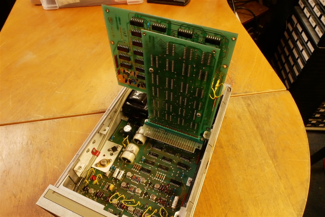

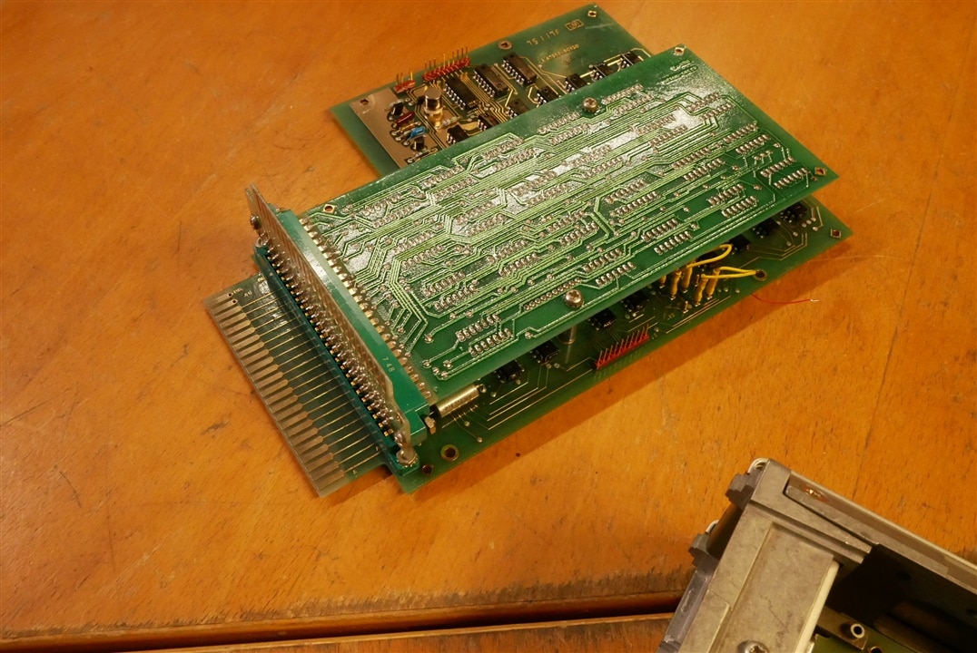

It uses the PCBs in  3 layer sandwich.
There’s a lot of logic on the middle board and all the components are on the “inside” faces of the sandwich so at first sight it looks like  a bit of  a monster to work on.
Pic of top/middle sandwich
Debug configuration
The HP guys thought about how you would fix it !

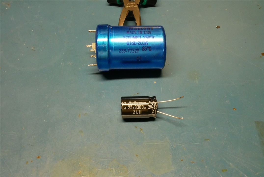

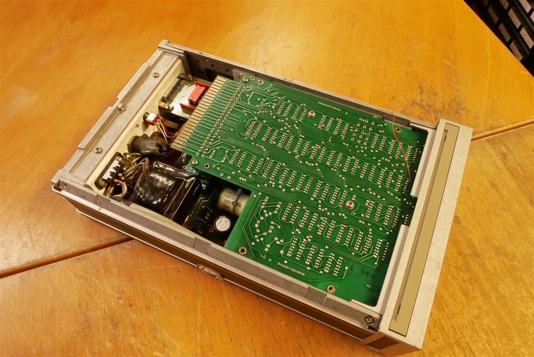

The first thing I did was take the covers off and look for smoked parts. There weren’t any so I powered it up and nothing happened (no lights, no smoke). Checking the power rails revealed no 5V DC supply but there was input to the regulator.
I replaced the LM309 linear voltage regulator with a 7805 and the 5V supply sort of worked. (5V with lots of 100Hz noise.)  I had to replace the reservoir capacitor as well.
It’s quite amazing how much smaller the modern 3300uF 25V cap is compared with the original Mallory 3200uF part. (Not a typo – 3200uF). It isn’t just chips that have got smaller.

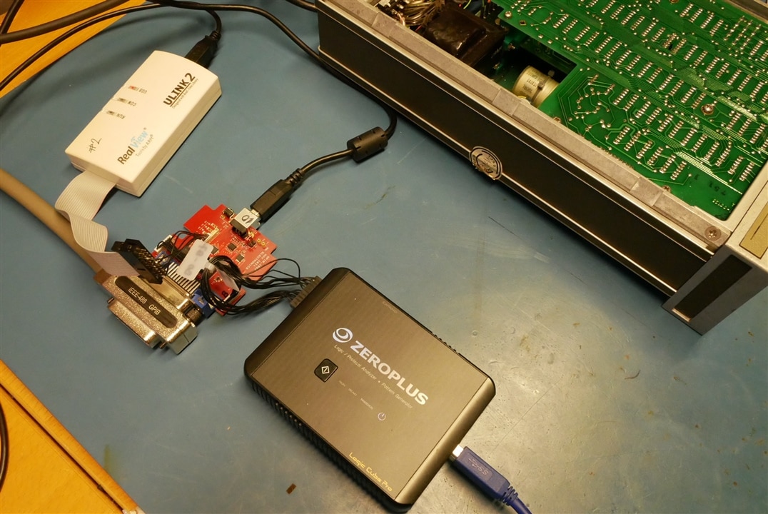

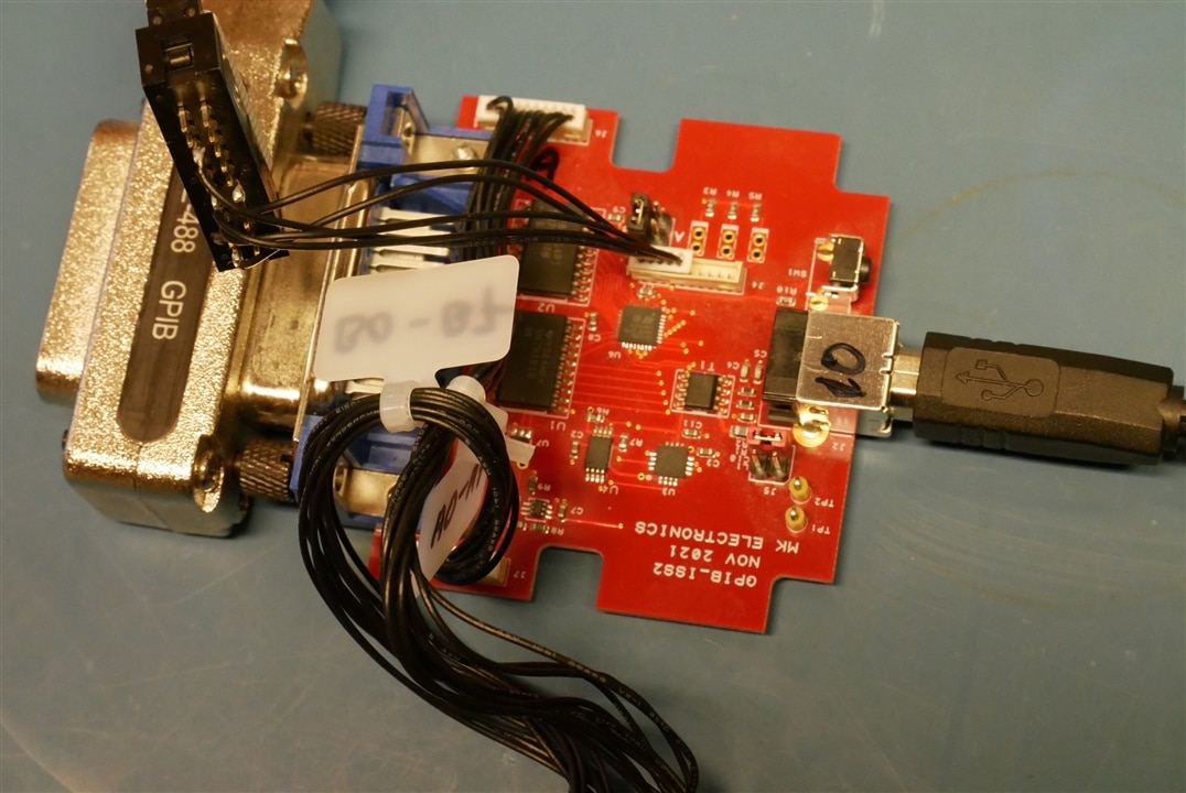

There are several designs on the web for DIY interfaces, but I hate taking the quick and simple route, so I designed my own !
It has features that the others don’t, mainly two connectors for a logic analyser (you’ll be seeing why soon).
But the main thing is that it’s my design and code so I can tweak it as I want – which leads us into another GPIB digression.

My interface now has an hp59313a mode of operation where it reads the data from the HP59313A and converts it to nice, signed decimal text strings.
GPIB is more than just the data bytes – timing and the 8 control lines matter too – which is why I have the logic analyser connections. It would be possible for the interface to double up as a bus analyser and I hear that the NI ones offer this  - I can’t comment on it because I’ve never used one (and at £1741 a pop I’m not planning to !).
 HPIB test rig, showing the approved way of using a home brew GPIB interface - connected to the processor debugger for on the fly improvements. The Zeroplus box is the logic analyser.
The GPIB interface. The two big chips are the bus interface buffers, the processor is the small QFN next to them.

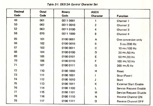

The HP59313A uses single character control codes:
The table makes it clear how the decoding logic (and it is logic chips) will react to the binary encoding of the ascii command characters. So, by using 1,2,4,8 to select 1,2,3,4 they save a 4- way multiplexer .
There are several other examples in the guts of the logic where they slightly complicate one function to eliminate some logic elsewhere.

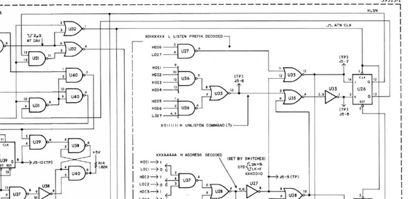

My HP59313A wouldn’t do any converting at all.
Looking at the bus when the controller sends the H (Reset) command the HP59313A doesn’t acknowledge it at all.
Pic of send H
Using the block diagrams and schematics gave me clues as to where to look and I found this on U26 on the top board:
Pic of U26 pins
U31-9 = U26-13 which doesn’t toggle when it should.
I replaced U26  - it was as SN7473 but I replaced it with an LS part because n one seems to sell standard 74 series logic now.
Of course the HP59313A still didn’t work and I had to replace two more logic chips, another 7473 and a 7410. I found them using the same technique, but they were a bit easier.

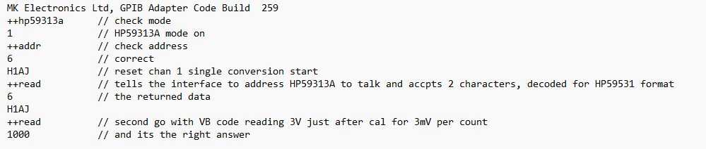

Testing the HP59313A
I wrote simple programme in VB6 (seems totally appropriate to use a language discontinued 25 years ago to test some hardware twice its age).
You can use any language you like, or even Hyperterminal.

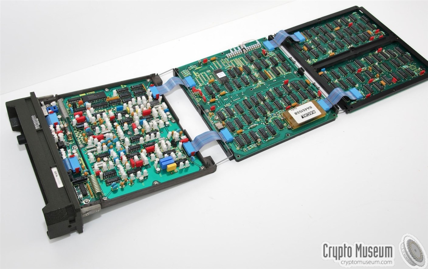

    Nice-looking hardware! Definitely fun exploring what's inside old equipment. A lot of the vintage stuff had so much logic ICs the boards are huge. I also liked this example of fitting in the boards (image source) to still allow for troubleshooting:
