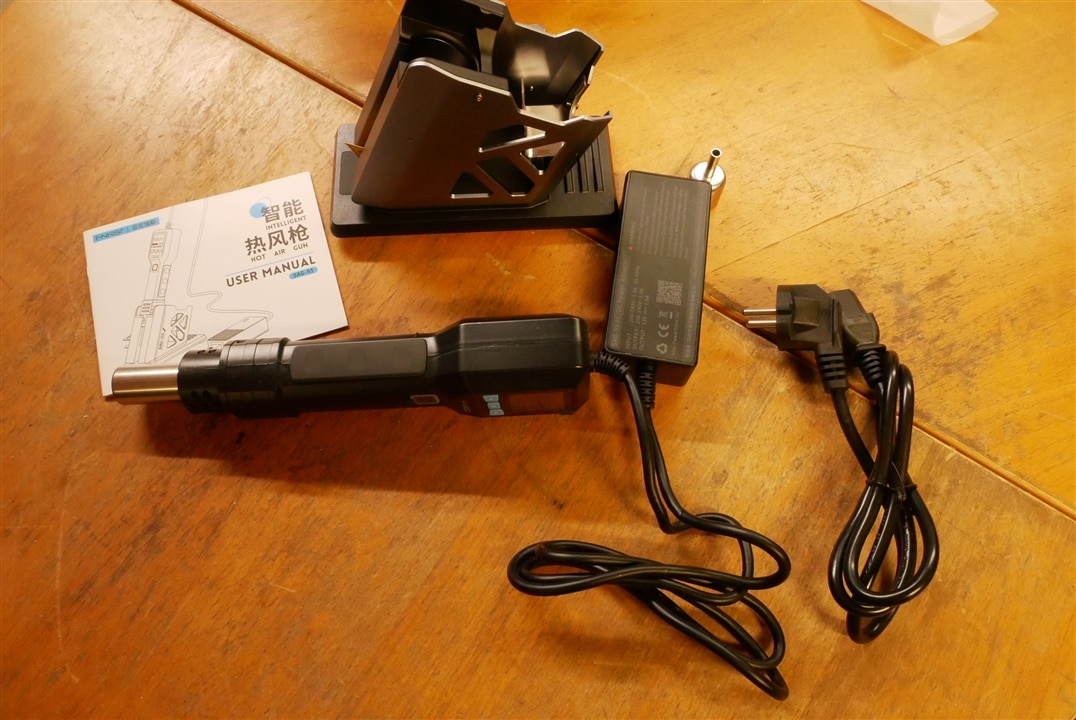

What you get for your money.
Ready to go
There is an instruction booklet, which seems fine.

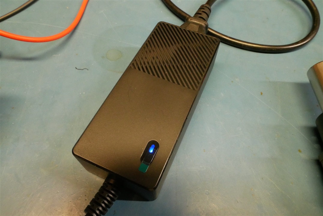

The power supply is hardwired to the hot air gun hand piece but uses a nice standard IEC main inlet. It's very light. It doesn't have all the approval marks that you often see but does have a manufacturer name and CE mark.

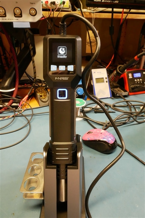

Start up screen.

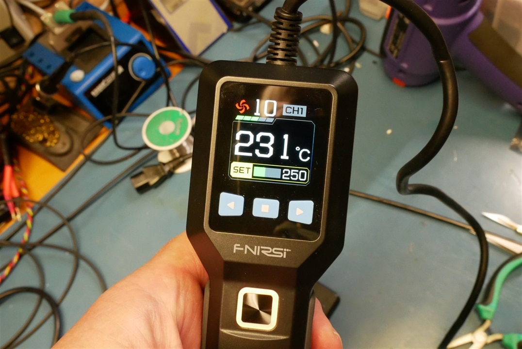

I tried to show the display and the thermometer at the same time, but you'll need to take my word for it that the SAG-55 was set to 350C during this test.

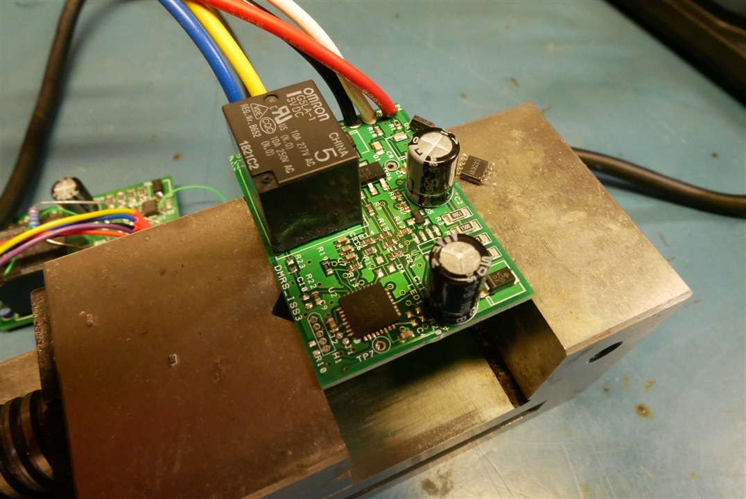

I pulled this board out of the scrap bag and removed some parts. I was able to remove a SOT23 transistor with the temperature set to 250C. Not using any board heating.
