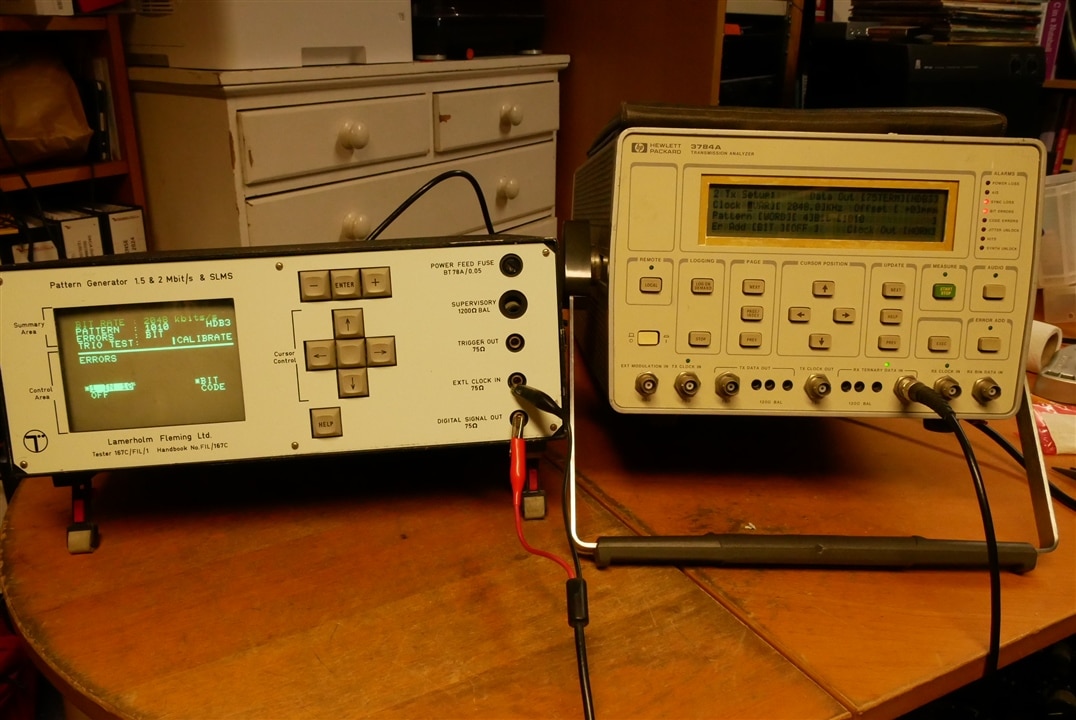

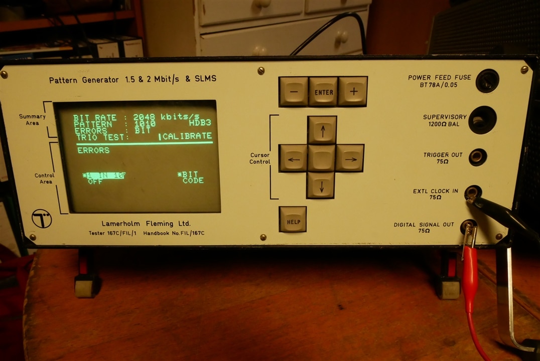

Bearing in mind that all three instruments are now about 35 years old it's impressive that they all work - and the 3784A can lock on to message from the 167C. One of the 167C features is that it can inject code or bit errors into a data pattern at any rate from 1 in 10E3 to 1 in 10E9.
In the test shown in the pictures the 167C is generating a pattern of 1010 encoded in HDB3 at 2048 bit/s and injecting bit errors at the rate of 1 in 10E6.

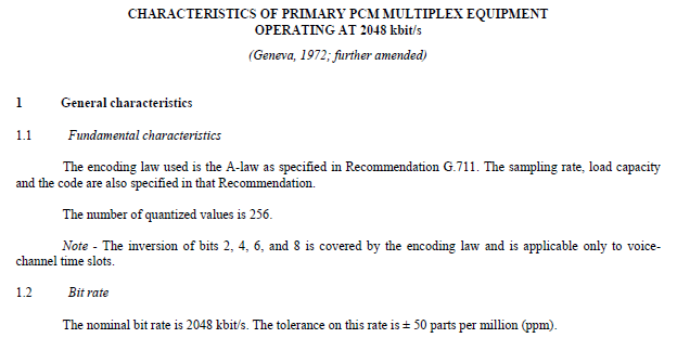

    The 167C only operates at 2.048 Mbit/s which is defined in (amongst other docs) G.732:
    So my recollection that we did nothing that special with our clock is probably correct, and the signals are within spec after 38 years !
    G.732 is delightfully vague for an official international spec, I liked this:
    It features a double fudge, "should be" rather than the modern "shall be" and  "a few seconds". Those were the days !

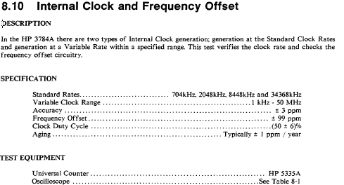

    michaelkellett over 1 year ago in reply to JWx
    The full service manual for the 3784A is available on line, complete with schematics and parts lists.
    In the operating manual they spec the clock like this:

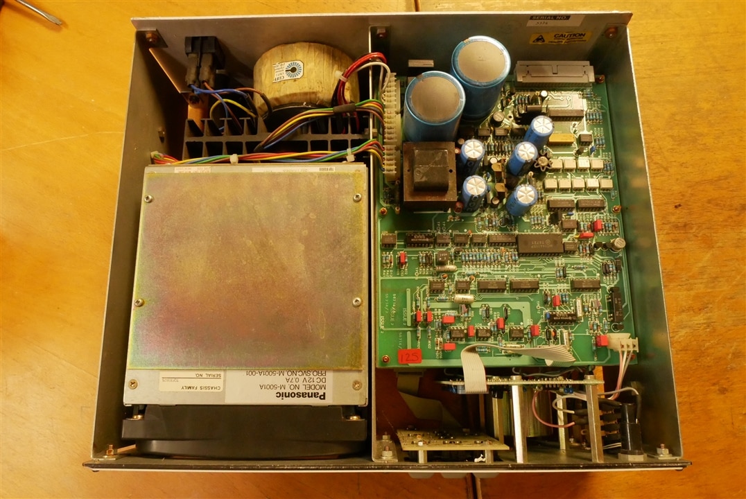

    167C with the covers off showing the top board which is mainly power supply stuff. The transformer on the PCB is a custom made dual bobbin 1:1 transformer with very low inter-winding capacitance. Its driven by a low frequency oscillator to generate a low noise isolated power supply for the analogue level measuring function. Yow can just see the selective filter with its huge ferrite inductor in a shiny metal hum shield at the bottom of the picture.

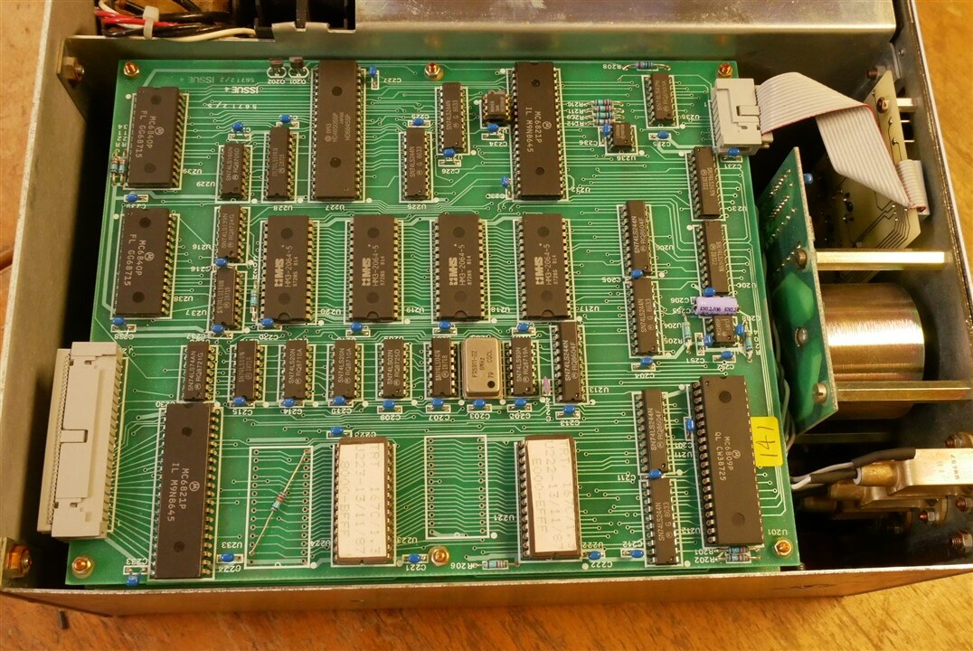

    167C processor board - the 8MHz clock only works the the processor (at 1MHz) but memory access was shared with the display so there were two memory accesses per 1us clock cycle.

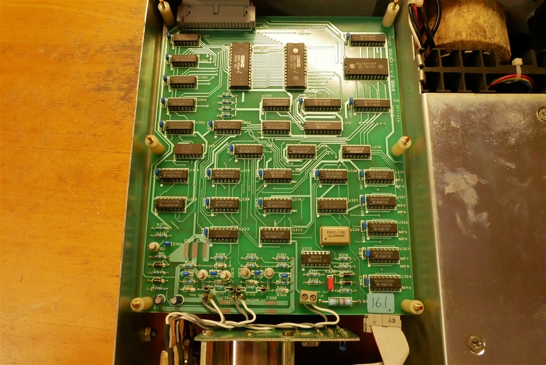

    Digital signal generating board with its own 12.288 MHz clock. The two 8kx8 static RAMS are used to store test patterns which are calculated by the micro.

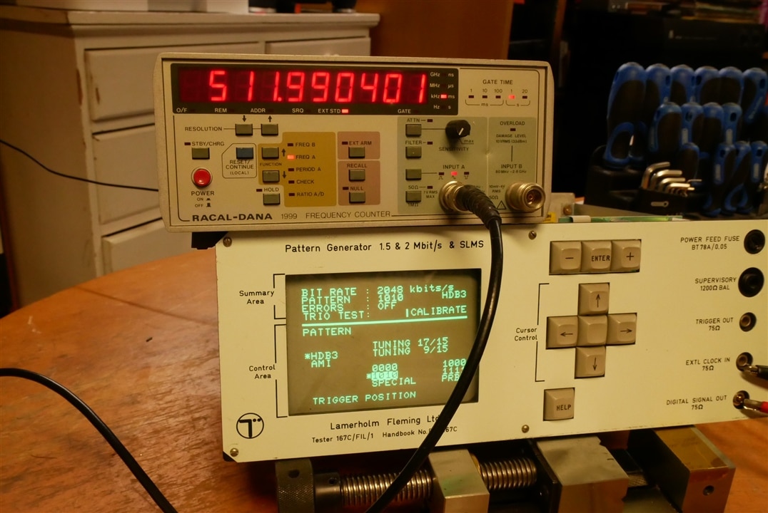

    The Racal frequency meter is using an external GPS disciplined clock (good for about 1ppb). This is about a minute after switching on the 167C. The pattern is 1010 so after HDB3 encoding you get 1/4 of the clock frequency. The 167C is -19ppm.

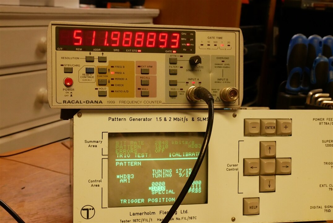

    After about 15 minutes warming (and it doesn't have the cover on !) and the 167C is -22ppm.

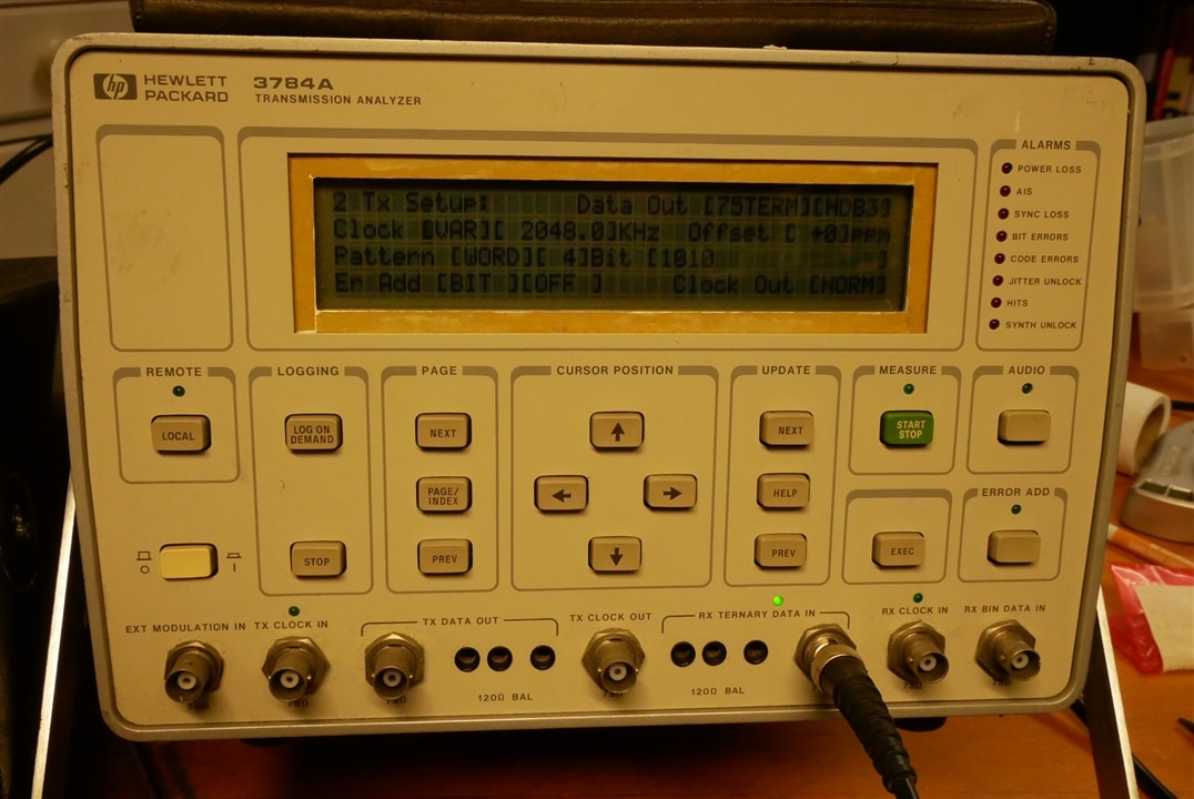

    The 3748A does a bit better on frequency accuracy, -1.25ppm
    So the conclusion here is that HP used  a (much) better clock oscillator than we did. I don't remember the 167C spec for sure but I think it was 20 or 25ppm. The 167C was not intended by BT to be used as universal test signal generator but as a portable trouble shooting tool - so precision frequency testing was outside its scope.
