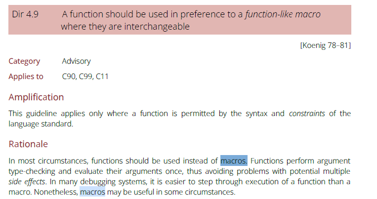

  • michaelkellett
    michaelkellett 6 months ago in reply to phoenixcomm
    I think you may be a little "off message" here Slight smile
    This is an extract from the MISRA C 2025 Guidlines:
    It says a lot more and gives examples but it's a paid for thing and I think the above is safely within the limit of fair use.
    Some of the examples are of when macro is a good (or even the only) way.
    It addresses your point that macros do not check types - which it considers to be a bad thing.
    Certainly I would rather the compiler generated an error than that hidden function used  a type conversion that I had not anticipated.

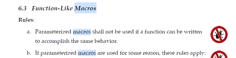

    The Barr Group Embedded C coding standard takes a harder line:
    It also give several examples.
    The Barr Group coding standard is quite  a good document and a free download - any serious C programmer should at least read it. (And almost certainly disagree with at least some of it !)
    My main reason for bringing all this up is less to influence how you write your C and more to make sure that other readers see both sides of the coin and can make up their own minds.

  • michaelkellett
    If you use a reasonably modern optimising C compiler the resulting code will often be the same if you use a #define for Sq or a function.
    (Because they inline short functions when optimising for speed.)
    Macros can be useful but can also make it very hard for other people to read your code - and the error messages the compiler makes when they are involved are sometimes not very helpful.
