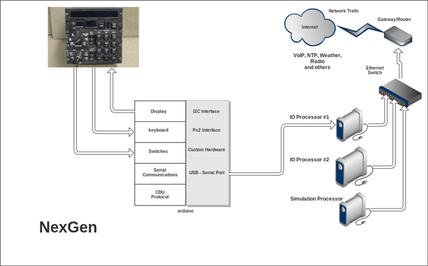

Ok so here is a map of our simulator:
  • A small network.
  • The CDU.
  • The IO Processor #1.
  • The Simulation Processor.
  • A block diagram of the arduino and what's it doing.
    • Interfaces to the display controllers via I2C.
    • Ps2 keyboard Interface.
    • The switches via some custom hardware.
    • USB virtual serial port.
    • Client Software.
  • A Virtual Serial Port, from the arduino to the IOP#1.
  • The Host software running on IOP#1
The Client Software running on the arduino duemilanove will use a one byte protocol. Valid data can be any 7 bit ASCII character or one of four (4) switches and its associated BCD data value.

    • The 4 switches 2 are BCD encoded thumb wheel switches, the rotary switches I use a 7->3 priority encoders, and a a 4->10 decoder for my address decoder. I use Tri-State buffers to switch the right switch to the bus ( that takes 4 quad packages), so my total parts count is 7 packages.
    • I chose a ps2 keyboard to handle my small keyboard (the controller is free) and the protocol is ubiquitous, and only cost me 2 I/O lines vs using the keyboard matrix input of my display controller, and that is a bit messy..
    • USB is good for 2 meters vs RS232 but then I would need a MAX level shifter, and Ethernet the overhead (software burden), is expensive, and besides this a point to point protocol.
    One more thought I don't do well with surface mount in my prototyping phase, and besides I just love wire wrap, (not manual) and  I have all the tools, and wire for the jobs, I have been using them for years...
    shabaz over 13 years ago in reply to phoenixcomm
    Hi,
    Just as an idea which maybe you are already considering, I find the I/O expanders (like PCA9535) quite nice for thumbwheel/rotary switches etc - they have an open drain interrupt pin, so there is no need to poll to check until there is an interrupt. If the keypad is not multiplexed, it might also replace a PS/2 controller, if you can read fast enough to keep up with key presses (I've not tried that).
    Also, maybe the USB is not needed (if it is removed then the raw serial could also be transported over the network in future if you needed to separate the control panel from the IO processor #1 by a long distance (I'm no expert, maybe there is no use-case for long distance in this application).
