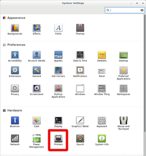

Now it's time to install your printer interface, which for some reason never made it into the release. So lets put it in now:
harrison@whirlwind:~$ sudo apt-get install system-config-printer
Now check your system menu and click on the wrench and screwdriver icon in the upper-left. You now should see a printer icon in your menu like this ---->>>
Its the icon with the red square around it.  There is no red square on your computer! image
