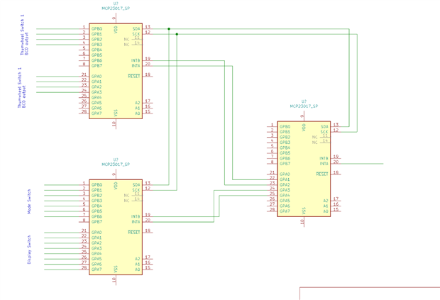

imagePROBLEM:
I have been struggling to find a solution to a mess that has stopped me from doing much with this project. The interconnection is weird 0.025" square, on a 0.1" center. Nothing fits this dam thing to make matters worse there are no manufacture part numbersimage
After being on the phone with AMP customer support and then he wants pictures, oh no. In my desperation, I called Samtec.
SOLUTION:
Guss what this damn thing is a standard connector. They are sending me a bunch of the little sobs. So I found out that I was looking for the TSW Series. I needed headers with the following configurations: 2, 8, 9, 14, 17. So the part number works out to TSW-1xx-07-F5 where xx are the pin counts.

The 185 pins will be connected to four (4) 50 pin male headers. Since I have no idea of which wire is which. So far this takes care of the displays. Now all that is left is to figure out the keyboard. I do believe it is a matrix keyboard of some sort. I will be using the MCP23017 I/O Expander for the dirty work. It is very nice and has INTA and INTB. this lends itself to all of the switches and the keyboard will be interrupt-driven.
Consider if I roll my own interrupt controller. There are 4 switches, plus the keyboard, that I have to contend with, 4 i/o expanders.
and 5 or 6 interrupts. Since the Arduino Mega has really on 4 useable interrupt pins I will take the interrupts from IC1A, 1B, 2A, 2B are inputs to an MCP23017 IC3A and this interrupt will go to one interrupt handler.  When the interrupt handler is called you look at its data which will tell you which switch data to look at.  image
One more MCP23017 will handle Keyboard, Microchip's AN101 describes via an interrupt. That leaves one for Communications.

    DAB over 5 years ago
    Nice job of tracking down the connectors.
    One of my first engineering projects was tracking down odd connects.
    Luckily they were still available, but in todays world, they become obsolete almost over night.
  • phoenixcomm
    phoenixcomm over 5 years ago in reply to DAB
    DAB thanks, the guy at AMP was dumber than a rock, it was a close tie with Trump image  The Samtec guy knew what it was when I said the pin was 0.025" square!!
    ~~ Cris
  • phoenixcomm
    ~~ Cris
    dougw over 5 years ago in reply to phoenixcomm
    Yep, I only have good things to say about Samtec.
