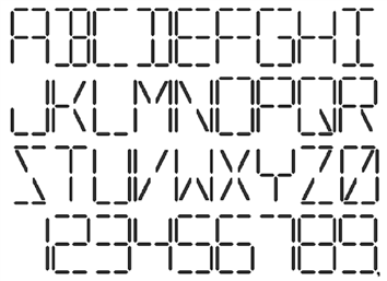

To drive this device is really quite simple, gee I wish I had some bi-polar PROMs image So I will have to do this the hard way. First I have to map the display to a letter. But the web to the rescue. there is a 16-segment font for your CRT etc.  So I still have a lot of work to do.

You will notice in table III  that I use an 'x' for TRUE or 1 and 'blank' for FALSE or 0.  Also, note my numbers start a 1 and then skips number 10. If you will notice I have 3 columns Letter, ASCII, and Index. I will use the Index column for my array but an array will not really work so you need a structure, see table IV the blue box on the right.
