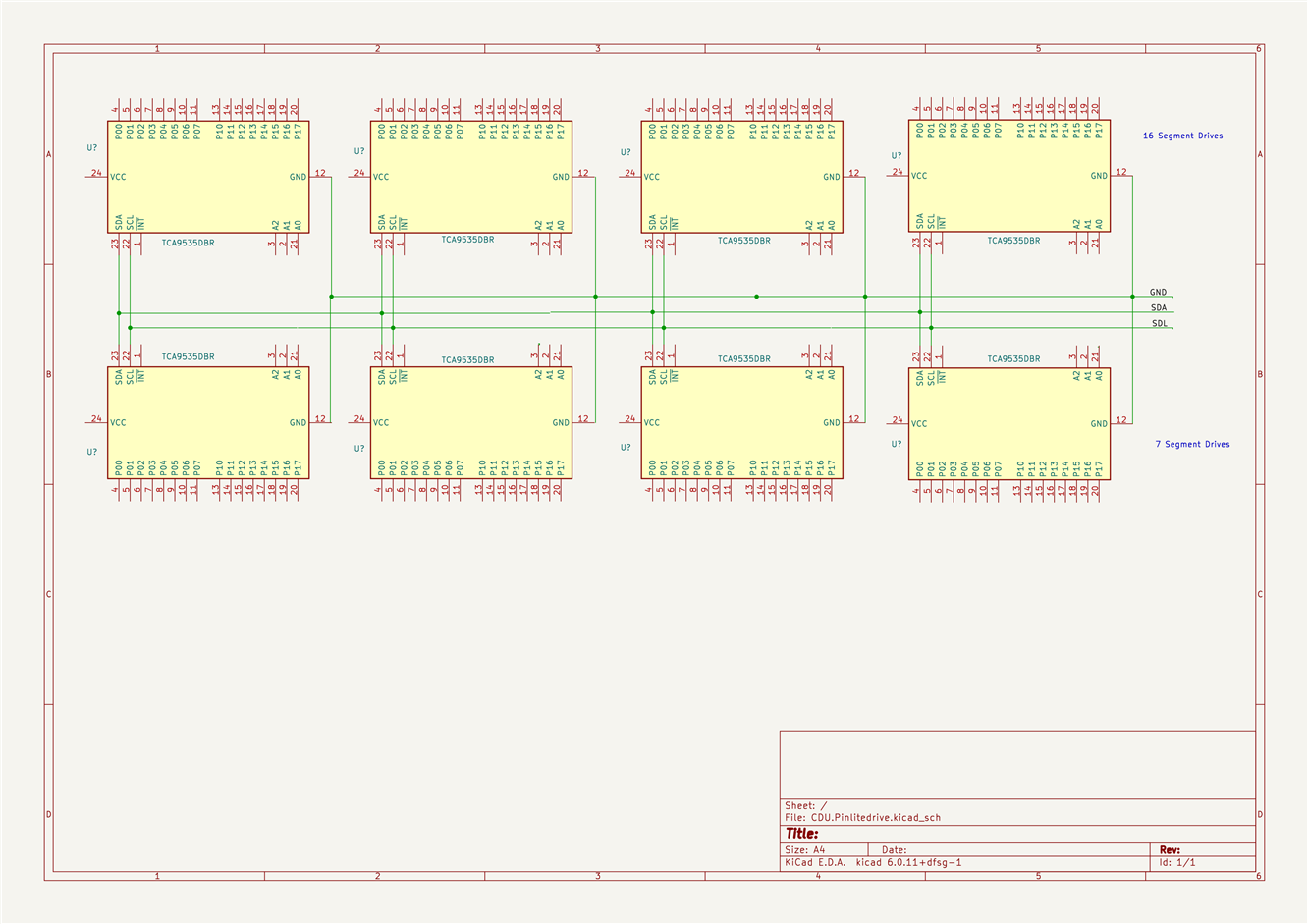

imageI took a long look at the mess that I created. And I said to myself: There has to be a better way!! A few PROMS or EPROMS would be supper, but alas I don't have a programmer anymore. image It looks like I will need a bunch of TI's PCF8575, 16-bit IO expander. The way it shakes out is that 8 should do it. 4 one for each of the four 16-segment displays, and 4 more for the 13 7-segment lamps, Now you ask how can I drive 13 lamps with four devices well I only need 4 bits which means I get 4 lamps per IO expander, I can store BCD in 4-bits, but I really only need 3-bits. each of the pins to drive a BCD to a 7-segment Decoder image drive a BCD to 7-segment Decoder, by doing
this I no longer have to worry about refresh times. I just found a new device an I2C EEPROM The EEPROM is a 24LC01 organized as 128 x 8 bits. So I can put the whole table in one IC, so for numbers 0-9 that's the first 9 words. in contrast, the alphas need more work. Remember we are dealing with bit patterns. So for each one of the alphas, I will need 16 bits for the pattern. So since I have lots of room I'm putting the high side from row 100 up, so it will take two reads and two writes
